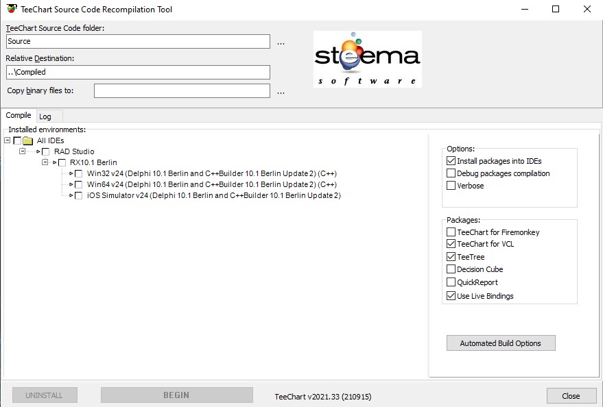

I am trying to install using the source code. (TeeChartVCLFMXSOURCE-2021.33.exe)
However, the option only shows 10.1 Berlin version even though I have 10.4 Sydney installed. How do I get it to have Sydney install option or are there instructions to modify for 10.4.

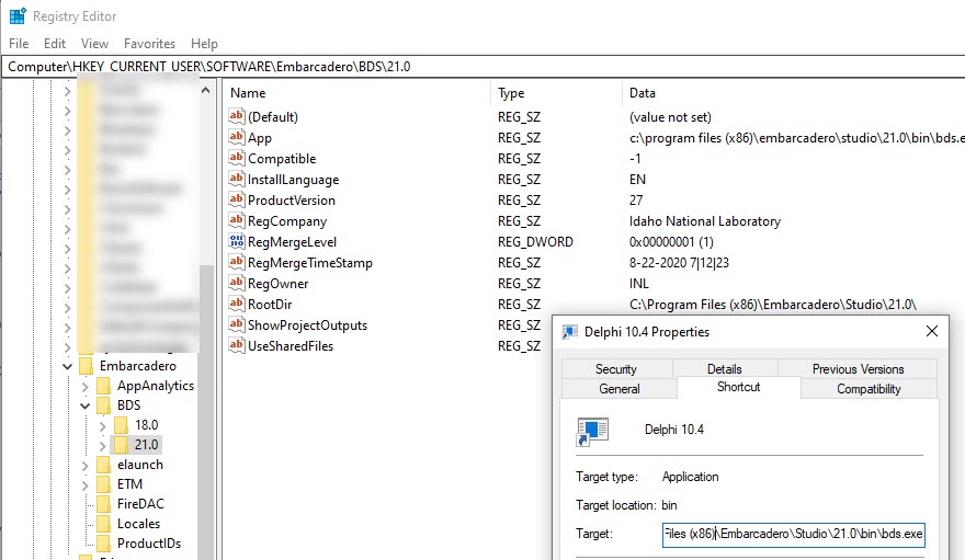

Do you have the "RootDir" value in this registry subkey?
"HKEY_CURRENT_USER\Software\Embarcadero\BDS\21.0"
This is the key TeeRecompile searches to identify RAD 10.4 Sydney is installed.

Post by INL » Mon Jan 10, 2022 3:23 pm
Yes, that path is in the registry and points to the 10.4 version of Delphi.
