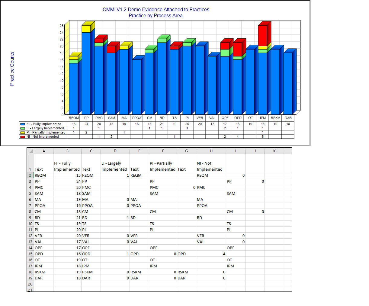

When I export chart data to XLSX some data is lost and some data is offset. In the image attached you can see the values in the data table and what shows up after export. Any ideas how to correct the export.
Mike Simmons
Data incorrect in export to XLSX
- DataExportIssue.jpg (281.02 KiB) Viewed 10808 times

Thanks for the file. We can reproduce the output you've obtained, We see that the older format, xls, saves apparently correctly. We'll work our way through it.
I've logged it asa bug here: http://bugs.steema.com/show_bug.cgi?id=2513
