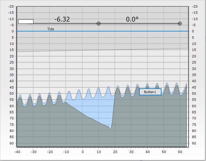

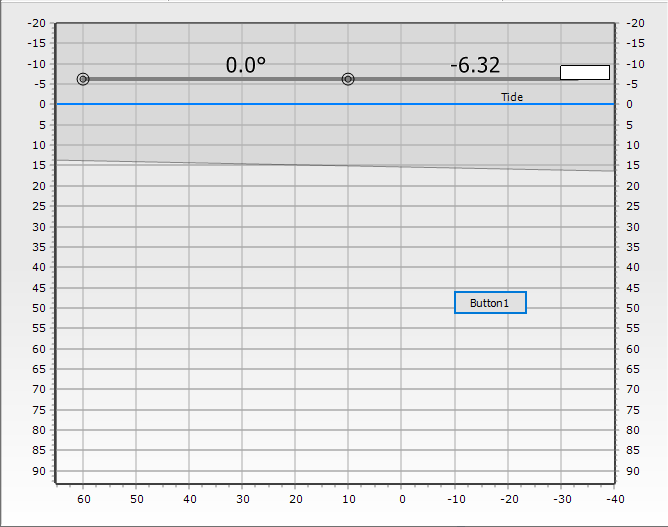

Can someone help me figure this one out? I have the chart (image 1) where if I invert it, the area series on the bottom disappear. The button on the form is a simple chart->BottomAxis->Inverted = ! chart->BottomAxis->Inverted. As you can see, everything inverts nicely except the area series. It just disappears.
