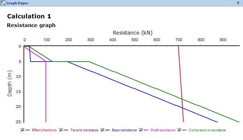

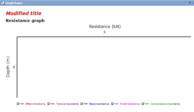

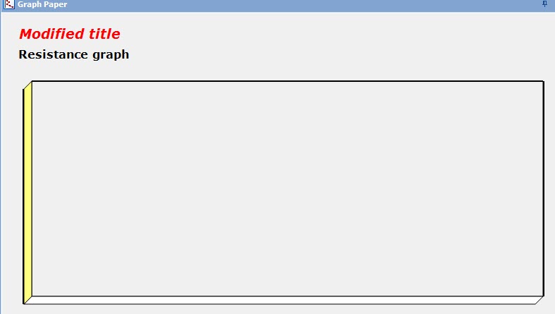

I have found the function LoadChartFromXMLFile but ...
After I have saved the same options to both the tee file and the xml file and then load those files, the tee file works as expected (apart form the data not being drawn) but the XML file does not. I attach three screenshots showing what I am getting:
Screenshot 1 = before saving to *.tee and *.xml files
Screenshot 2 = after loading *.tee and *.xml file
Screenshot 3 = after loading *.xml file
Has anyone had this problem before?

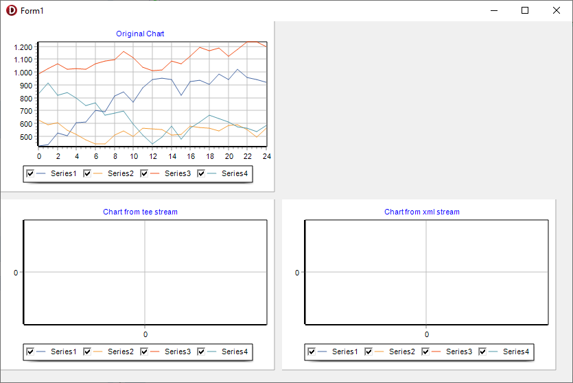

I've done a test and it seems to work fine for me here both without and with data:
Note I'm using streams instead of files, but it shouldn't be very different:
uses Chart, Series, TeeGDIPlus, TeeStore, TeeProcs;
var origChart, teeChart, xmlChart: TChart;
var i: Integer;
    teeStream, xmlStream: TMemoryStream;
const withData=false;
  //Create origChart
  origChart:=TChart.Create(Self);
  origChart.Parent:=Self;
  origChart.View3D:=False;
  origChart.Gradient.Visible:=False;
  origChart.Color:=clWhite;
  origChart.Walls.Back.Gradient.Visible:=False;
  origChart.Walls.Back.Color:=clWhite;
  origChart.Title.Text.Text:='Original Chart';
  origChart.Legend.CheckBoxes:=True;
  origChart.Legend.Alignment:=laBottom;
  for i:=0 to 3 do
    origChart.AddSeries(TLineSeries).FillSampleValues;
  //Export to tee stream
  teeStream:=TMemoryStream.Create;
  SaveChartToStream(origChart, teeStream, withData);
  //Load tee stream to teeChart
  teeStream.Position:=0;
  teeChart:=TChart.Create(Self);
  LoadChartFromStream(teeChart, teeStream);
  teeChart.Parent:=Self;
  teeChart.Title.Text.Text:='Chart from tee stream';
  teeChart.Top:=origChart.Height+10;
  //Export to xml stream
  xmlStream:=TMemoryStream.Create;
  SaveChartToXMLStream(origChart, xmlStream, withData);
  xmlStream.Position:=0;
  xmlChart:=TChart.Create(Self);
  LoadChartFromStream(xmlChart, ConvertXMLToText(xmlStream));
  xmlChart.Parent:=Self;
  xmlChart.Title.Text.Text:='Chart from xml stream';
  xmlChart.Top:=origChart.Height+10;
  xmlChart.Left:=origChart.Width+10;
