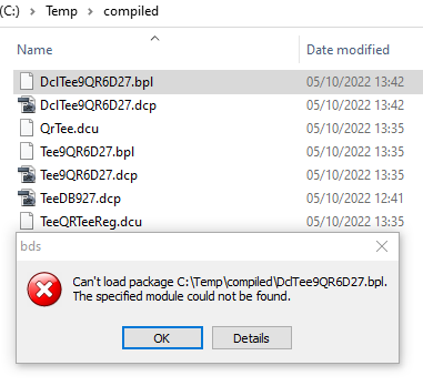

Re: Unable to build Tee9QR6D27 - QuickReport 6 Chart- Required package 'QRWRunDXE10_4_w64' not found
I have managed to install the components on one Windows installation but still fail, despite repeated attempts, to install on the second (main installation).
I have tried a few suggestions from StackOverflow without success. Do you have any idea as to why I get this message, no matter what I try ...
Copying the packages to the default locations helps the IDE to load the packages:
- Design-time package ("compiled\Bpl\Win32\DclTee*.bpl") -> "bin" folder in the IDE
- 32bit runtime packages ("compiled\Bpl\Win32\Tee*.bpl") -> "Windows\SysWOW64"
- 64bit runtime packages ("compiled\Bpl\Win64\Tee*.bpl") -> "Windows\System32"

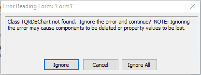

Well over the last couple of days I've tried everything I can think of, all to no avail.
I've uninstalled Delphi completely, wiped the folders and registry, tried Delphi 11 - but could not find components for TQRChart. So back to Delphi 10.4, from scratch, and still the same problems as before!
I also found that the installation I thought was working has some sort of bug. I can add a Quick Report and a QRChart and it works. But if I save the project, then reload I get the attached "Class TQRDBChart not found" error. I did not add a QRDBChart and no series use a DB.
What happens is that a TQRDBChart component gets inserted inside the TQRChart component, in the .dfm file, upon saving. It works before saving but not when reloaded.
So despite a whole week of trying I still can't get QRChart working with QR6 and Delphi 10.4.
Is there anyone at all successfully using QRChart with D10.4 and QR6 (and saving/reloading)?
Thank you. I will try that.
Did you manage to find the bug where a TQRDBChart component gets inserted inside the TQRChart component when saving?
On the one installation where I managed to get QRChart working I still can't use it, after reloading.
I can recreate the form, from scratch, compile and run fine. But when I save and reload the form I get the error I mentioned in my last message.
Were you able to recreate that error?
Apologies, I see now that you were referring to the other error I mentioned. I have tried adding various Library paths, but nothing has helped, so far.
The TQRDBChart does not seem to be registered in the first place. When I installed the components the only component listed as added is TQBChart.
I don't seem to have any source code for QuickReports, so I don't see a way to edit the runtime package.
Where did you find the source code to make the change?
