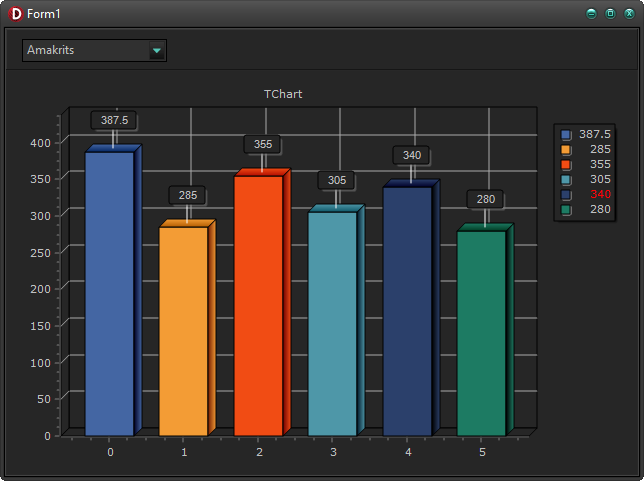

In Delphi I can set Styles (ProjectOptions -> Application -> Appearance -> CustomStyles) .
For example if I set it to style "Amakrits" then the UI has a black theme, the TListboxes and Memo's background are black.
But the TChart background remains white.
Is there a way that TChart adapts its style automatically to the Delphi style?
If not, I can set the TChart colors manually. But how can I find which exact colors Delphi used in a certain style?
Re: Custom Styles
Post by Yeray » Mon Feb 13, 2023 10:56 am
You can assign the current style as follows:
uses VCLTee.TeeThemes;
TSystemTheme.ApplyStyle(Chart1);
