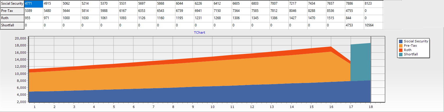

Post by Test Always #? » Thu Mar 23, 2023 5:09 pm
Thank you for your response.
Here is a link to an image that I have working (sorry, I could not get the "img" tags to work and display the image in the preview):
http://www.tbinc.com/misc/A.jpg
When the cash flows get more complex, it falls apart--e.g., incomes starting and stopping. It took me a lot of work to get this one working.
I need them to step down, not slide down.
Does that make sense?

Re: Stepping as stacked area series to/from zero values
Post by Yeray » Fri Mar 24, 2023 6:24 pm
The link to the image seems broken.
You can use attachments.

Post by Test Always #? » Fri Mar 24, 2023 11:09 pm
Sorry, the link should have been:

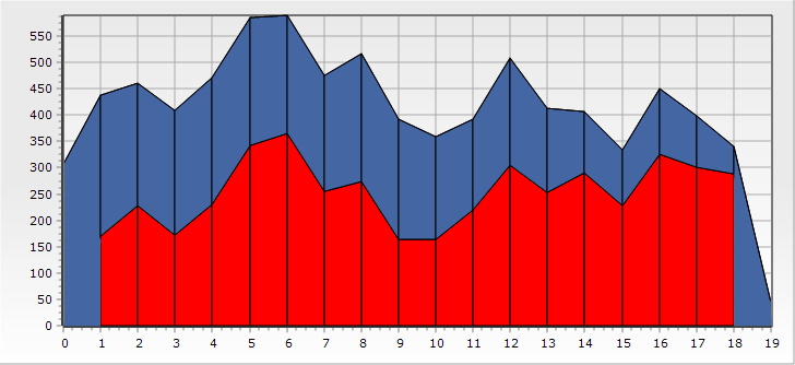

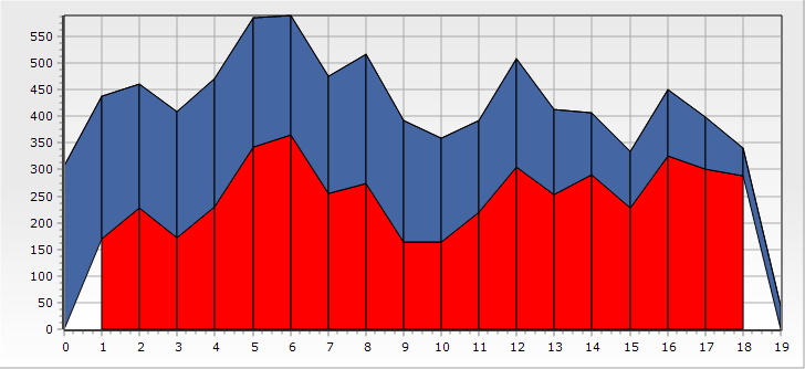

Checking this to see how it can be done. If the rules are:
1. If a value is followed by a zero then no direct join is made to the next point, rather a step downwards is made at the x-location of the last non-zero value.
2. If the predecessor to a value is zero, no direct join is made rather a step up is made at the x-location where the non-zero value occurs.
That would give this chart (a simulation) for the data in the example project:
Does that agree with what you expect to see?
With thanks.
Posts: 1319
Location: Girona
Post by Marc » Tue Apr 18, 2023 4:33 pm
We see a obstacle to us adding the step-up/down as a generic feature because for stacked charts, if another series in the stack has values and another doesn't, a stack could show up as hollow
ie.
which is, data-wise, true to the values of the blue series, but aesthetically not particularly attractive,
or .... to fill-down the blue.
ie.
which is aesthetically easier on the eye, but data-wise gives the impression that, for example, the penultimate blue value is very large, which it isn't.
We are up for thinking this through further and working with any feedback, but at the moment we feel that a generic implementation wouldn't be true to the data in many cases.
