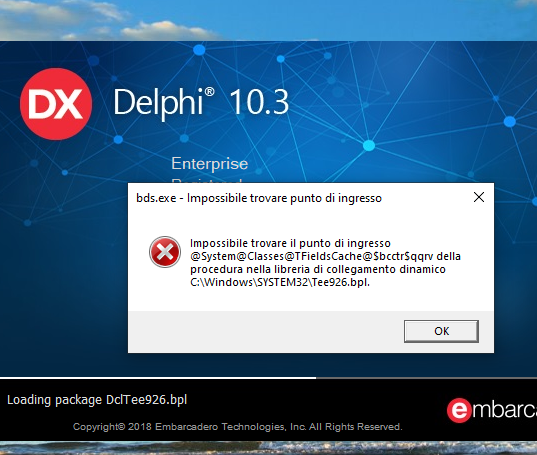

I'm trying to install TeeChartVCLFMXStandard-2023.37 with Delphi 10.3 (O.S. Windows 10 Pro 22H2 19045.2965)
The installation itself works but at Delphi boot I receive a series of exceptions concerning the impossibility of finding the entry points of the various bpl
From the package list in Delphi, none have been installed (not checked) and if I try to check the packages I get the same exceptions

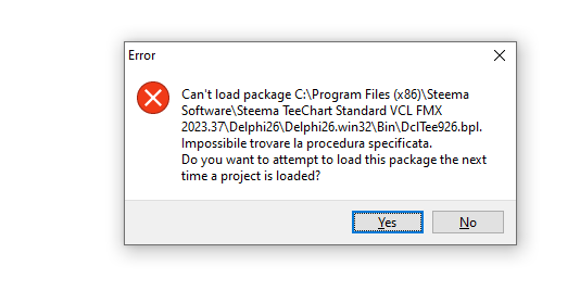

- Sample error at boot delphi
- cantload.png (12.01 KiB) Viewed 61158 times

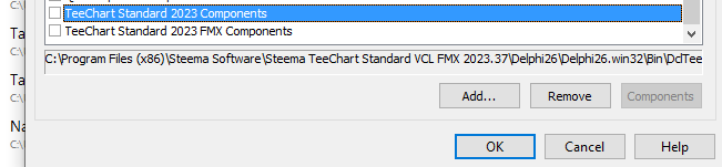

- install packages list
- error install package.png (11.03 KiB) Viewed 61158 times
- error n 1.png (208.56 KiB) Viewed 61158 times

Do you have all the updates installed in the IDE?
https://docwiki.embarcadero.com/RADStud ... at%27s_New
Note we always build the binary installers with all the updates installed, and these kind of errors use to mean some packages in the IDE are different to those used to build the packages.

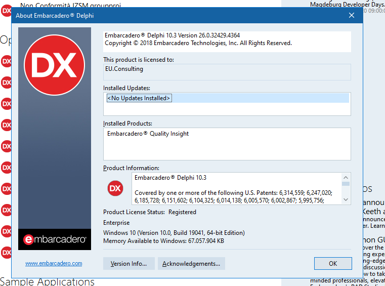

- delphi version
- delphi ver.png (61.6 KiB) Viewed 61142 times

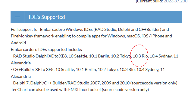

I don't find it professional of Steema to sell a product without exact specifications.Yeray wrote: ↑Tue May 23, 2023 12:55 pmHello,
In the notes we talk about the supported version of delphi 10.3, we don't talk about subversion.
Even to a request for help in tracking down a suitable version not even a response.
In the purchase notes we talk about 30 days of support included in the price, support that after 2 days does not give answers.
It is assumed that those who buy products like yours want to use it to do business and not because they are bored watching TV.
It's with the money of people like me that your company keeps going, this is lack of organization and respect for the customer.
With patience and considerable waste of time (and my time is worth as much as yours) I tracked down the version that works with my Delphi 10.3 the fact remains that a few days ago I bought a new product and I just have to use one from 2019 because the versioning problem is not clearly explained.
Luckily I only bought the base to start trying.
If you were in Italy I would have dragged you to court.
- from your site
- Immagine.png (19.33 KiB) Viewed 61088 times

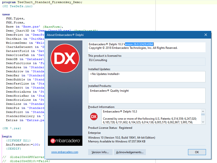

The version I use is delphi 10.3 Version 26.0.32429.4364
I am also attaching the screen shoot of the delphi version to be more sure (delphiver.png)

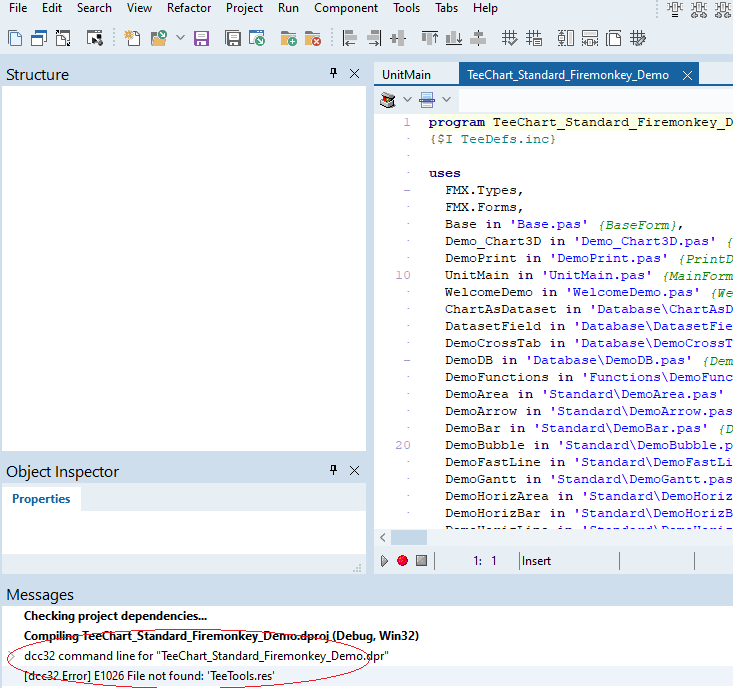

I inform you that the demo Teechart_Standard_Firemonkey_Demo has a compilation error, the TeeTools.res is missing (I am attaching a screen shoot)
I look forward to a resolution of the problem and thank you very much again.

- compiler error demo teechart
- compiler error example teechart.png (46.09 KiB) Viewed 61018 times
- delphi ver 10.3
- Delphi ver.png (75.15 KiB) Viewed 61018 times
