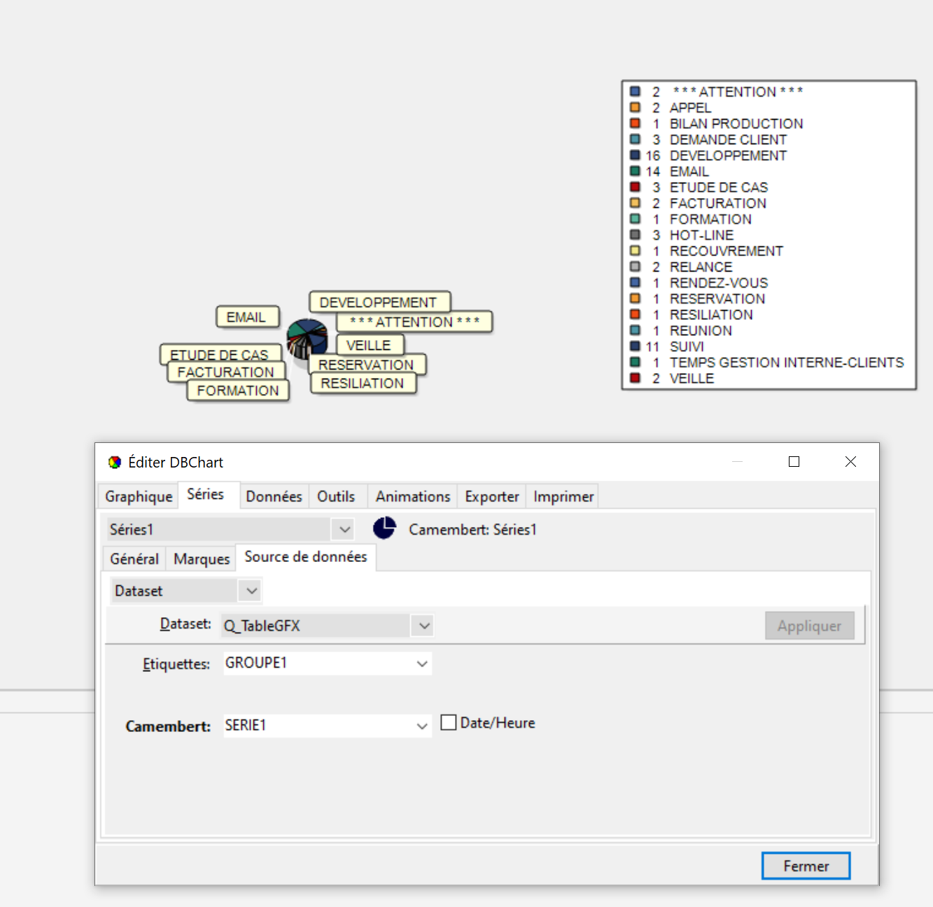

In an empty project it's work fine. It's display my (multiple record) dataset.

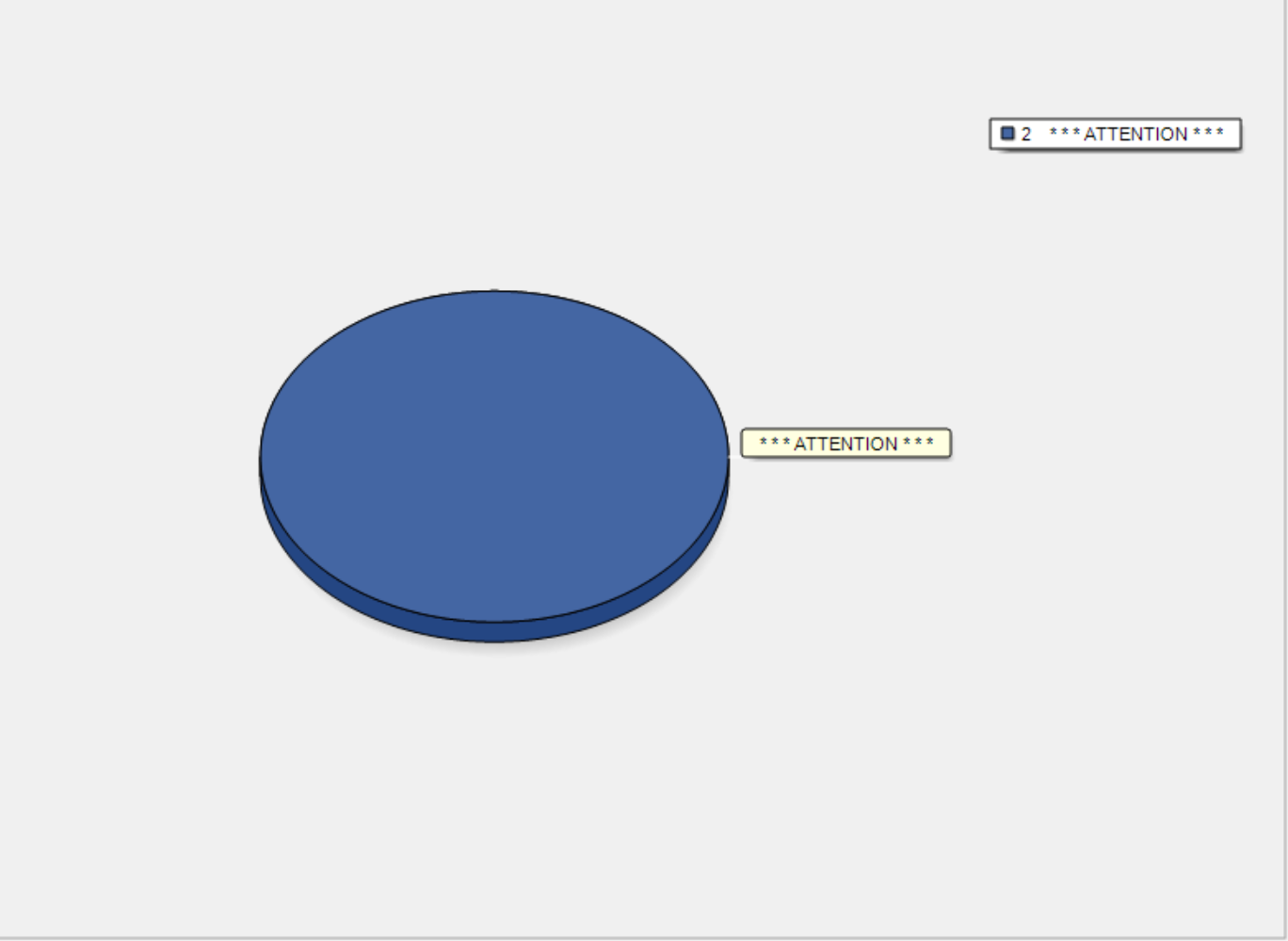

But in my 7 millions of line of code program with the same code my TDBChart display a Single record like this :
and result :
But I want = If I edit (in runtime) my TDBChart to connect to a dataset it's work :

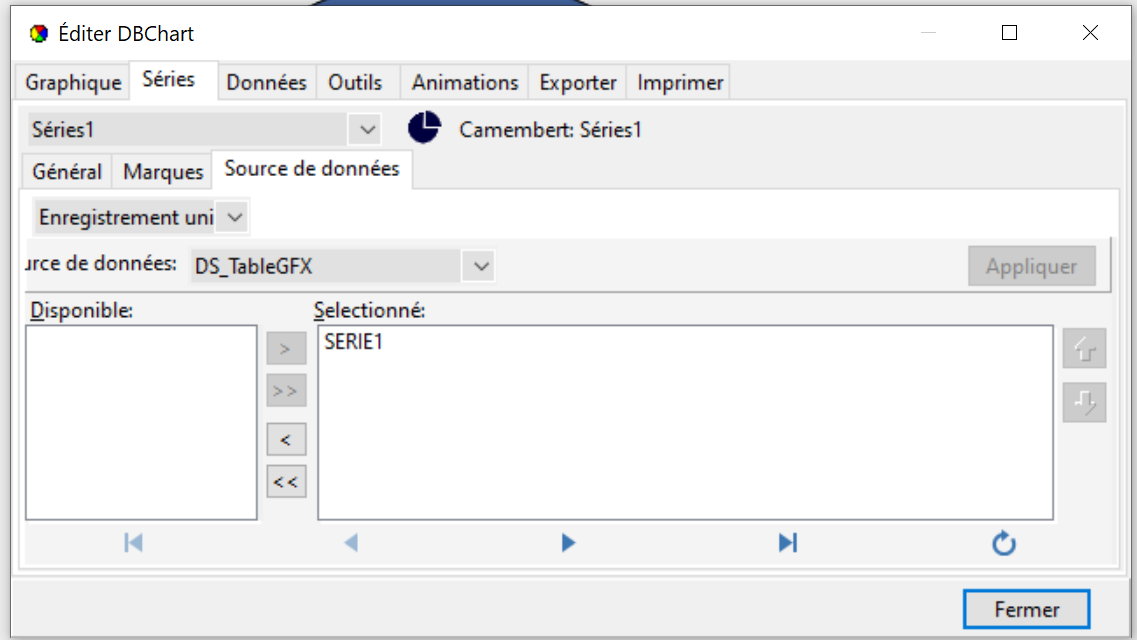

Ok I have understand my mistake.
It's if you connect DBChart1.Series[0].DataSource to a TDatasource component (connected to a Tdataset) !
Strangely in this case it display a "single record" ?!
