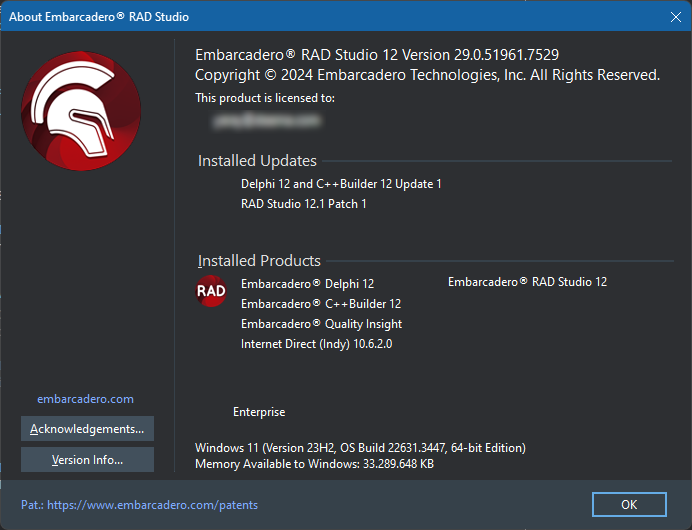

I just installed the binary chart 2024.40 version for Delphi 12 (the About box says 12 Version 29.0.51511.6924)--I think it is 12.1
It says 29.0.51961.7529 for me:
Does the "Installed Updates" section list "Update 1" for you?
The "6924" build seems to be the 12.0 + Patch 1 (ref here), not the 12.1.
