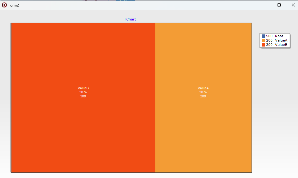

Do you know how to remove the "Root" element from the legend ? It distorts the display of the % .
I have 30% and 20% instead of 60% and 40%:
Capture d’écran 2024-12-13 183908.png (11.73 KiB) Viewed 55300 times
The easiest way I can think on is to duplicate the SquarifiedMapSeries; the second one without the root element so it won't be drawn in the chart but can be drawn in the legend.
Try setting Totalize:=False before calling FinishData.

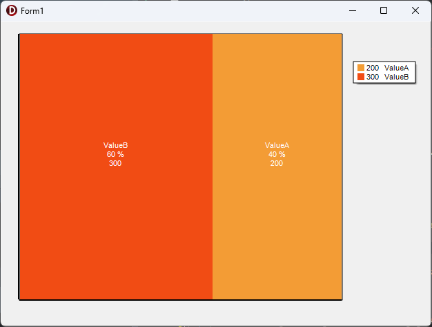

Here a simple example:
uses Chart, TeEngine, TeeSquarifiedMap;
var Chart1: TChart;
var t: Integer;
    squari: TSquarifiedMapSeries;
  Chart1:=TChart.Create(Self);
  Chart1.Parent:=Self;
  Chart1.Align:=alClient;
  Chart1.View3D:=False;
  squari:=TSquarifiedMapSeries(Chart1.AddSeries(TSquarifiedMapSeries));
  squari.AddItem(-1,0,'Root');
  squari.AddItem(0,200,'ValueA');
  squari.AddItem(0,300,'ValueB');
  squari.Totalize:=False;
  squari.FinishData;
  squari.ShowInLegend:=False; // as per default
  squari.Marks.Style:=smsLabelPercentValue;
  squari.Marks.MultiLine:=True;
  with TSquarifiedMapSeries(Chart1.AddSeries(TSquarifiedMapSeries)) do
    for t:=1 to Chart1[0].Count-1 do
      AddItem(0, squari.Values[t], squari.Labels[t]);
      ValueColor[Count-1]:=OperaPalette[t];
    ShowInLegend:=True;

Perfect,
Thanks Yeray :D
