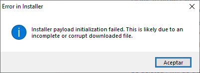

I have this problem installing the latest version of teechart (TeeChartVCLFMX-2025.43-Offline.exe).
The installation is done through the network.
Is network installation supported? Thank you very much.
Installation problems
- 2025-05-14_09-03-32.png (5.15 KiB) Viewed 27945 times

Re: Installation problems
I need the offline installer. Due to company security policies.
To install it is left on a server and run over the network from that server.
I downloaded it again through the link and it is the same file (MD5 checksum (6ccaad6bba47b53241823e658e329cd8)) .
Could it be that the problem is because network installation is not allowed?’
It doesn't even ask for the licence, nor does it start the GUI.
We also have licenses but the error is when starting the setup.
Could it be that network installation is not supported?

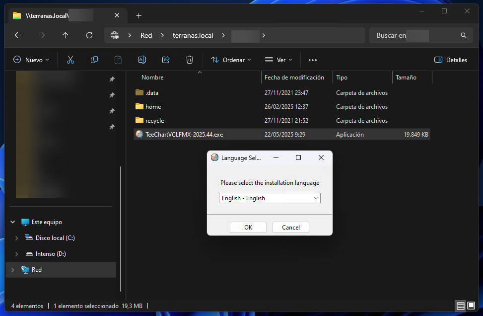

No. I have the setup on a secure file server.
Just access that drive and double click on the setup.
I imagine it will try to unzip something and will not have permissions on that drive.
I've been able to run the installer from a shared folder without issues
Check the permissions in that folder.
