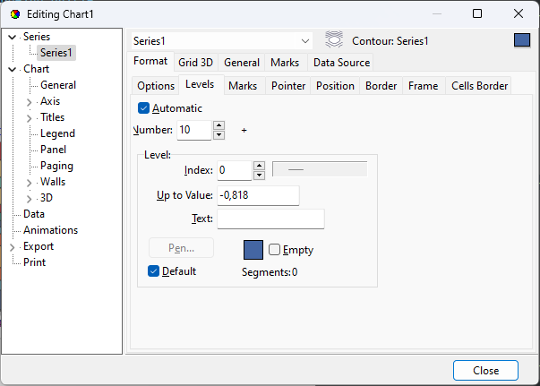

You can show the "Levels" tab in the Chart Editor adding the "TeeContourEdit" pragma link:
.cpp:
#pragma link "VCLTee.TeeContourEdit"
Then you can untick the "automatic" checkbox and play with the levels.
