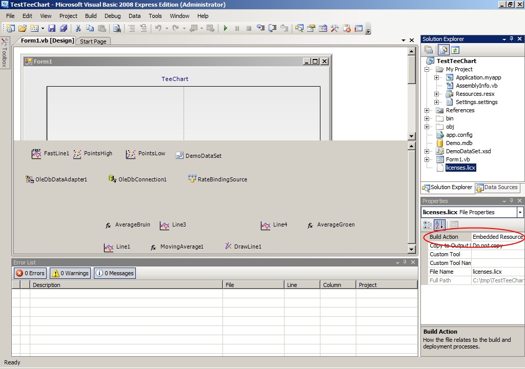

Re: How to get the TeeRegV3.exe utility?
Hi André,
You can find it at the right-bottom, at the Properties window when selecting licenses.licx (find it in the Solution Explorer window):

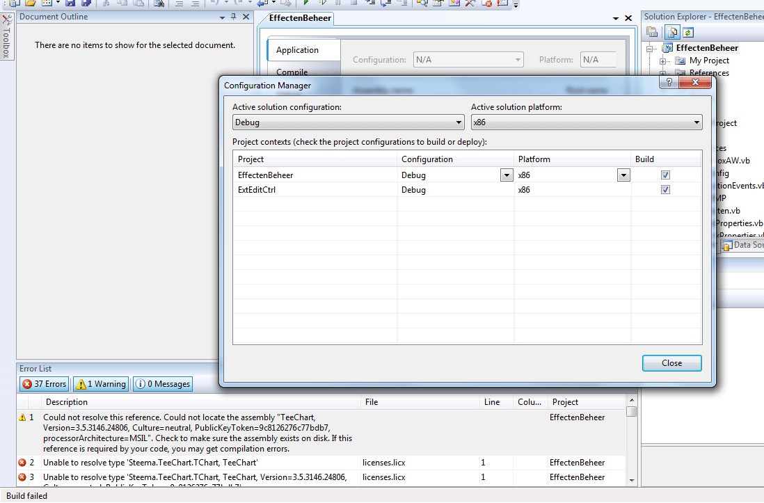

Hi Narcis,
the setting of the build action was already set to Embedded Resource, but I still get the error messgaes if I change the project to X86:
André Wolff
André Wolff
Hi André,
You can try using the update build. However, the warning and errors in the image you sent says the project can not resolve TeeChart build 3.5.3146.24806. As you can see in the release notes this is a build much older than 30th July 2009. That's what makes me think your project may not be referencing correct TeeChart assembly. You may want to remove its TeeChart.dll reference, add 30th July build manually to the references section and check that AssemblyFolders in the registry don't point to an old TeeChart version. I also see the project name is different to the test project you sent. Did yo got the example project working fine at your end?
Hi Narcis,
I installed on my Windows 7 system your build 3.5.3498.27368. This version nr is given in file release.txt in map C:\Program Files (x86)\Steema Software\TeeChart for .NET v3
But if I look in the Project References, the version indicated there is 3.5.3146.24806 which is not on my PC!
In the references I removed the reference to the TeeChart vs 3.5.3146.24806 and I added TeeChart Pro vs 3.5.3498.27368 and made a new build without problems (file licenses.licx was not in the project).
Next I changed via Build / Configuration manager the Active solution platform to X86 and I could rebuild the solution without problems and I could run it without problems!!
