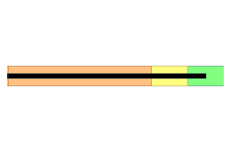

I have tried with the Linear gauge but I can't get the layout I need, I have an absolute requirement to replicate the horizontal bullet graphs as shown in the wiki, with the exception that I don't want to show the scale. With the linear gauge I can't get the 3 colour bands. Here is what I've go so far using 4 horizontal bars with stack set to none.
The first 3 horizontal bars are used to set up the colour qualatative bands, the third bar (Black) shows the value, I just set this to be a little thinner that the others, all I am missing in the vertical comparative metric.
I can add a fifth bar to show the comparative metric, but my client really wants a vertical marker not the line.
So any suggestions on how to get a vertical marker... or any marker at a specific point along the graph whoul dbe much appreciated.

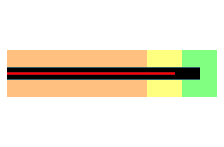

Post by Yeray » Tue Apr 27, 2010 4:02 pm
Hi Captell,
Have you tried with custom labels? You can remove all your bottom axes labels and add only those you want. And you can hide the grid if you don't like it.
If you don't want even the axis horizontal line, I'm afraid you should draw your text directly to the canvas at OnAfterDraw method. Here it is an example of both possibilities:
            Steema.TeeChart.Styles.HorizBar tmpBar;
            Random rnd = new Random();
            int nValues = 2;
            int nParts = 3;
            for (int i = 0; i < nParts+2; i++)
                tmpBar = new Steema.TeeChart.Styles.HorizBar(tChart1.Chart);
                tmpBar.MultiBar = Steema.TeeChart.Styles.MultiBars.None;
                tmpBar.Marks.Visible = false;
                if (i < nParts)
                    for (int j = 0; j < nValues; j++)
                        tmpBar.Add(rnd.Next(10) + ((nValues - i + 1) * 10));
                    if (i == nParts)
                        tmpBar.CustomBarWidth = 20;
                            tmpBar.Add(rnd.Next((int)(tChart1[0].XValues[j])));
                        tmpBar.CustomBarWidth = 10;
                            tmpBar.Add(rnd.Next((int)(tChart1[tChart1.Series.Count-2].XValues[j])));
            tChart1.Draw();
            tChart1.Axes.Left.Automatic = false;
            tChart1.Axes.Left.MaximumOffset = 70;
            tChart1.Axes.Left.MinimumOffset = 70;
            tChart1.Axes.Left.Visible = false;
            tChart1.Axes.Bottom.RelativePosition = 70;
            tChart1.Axes.Bottom.Grid.Visible = false;
            tChart1.Axes.Bottom.Labels.Items.Add(tChart1[0].XValues[1]);
            tChart1.Axes.Bottom.Labels.Items.Add(tChart1[1].XValues[1]);
            tChart1.Axes.Bottom.Labels.Items.Add(tChart1[2].XValues[1]);
            int tmpLeft = tChart1[1].CalcXPos(0);
            int tmpTop = tChart1[1].CalcYPos(0) + 100;
            g.TextOut(tmpLeft, tmpTop, tChart1[1].XValues[0].ToString());
