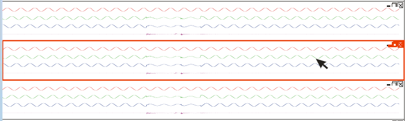

1. How can I highlight the chart area border of a custom vertical axis as shown in the attached image at runtime?
2. Is there a way to put buttons similar to form ControlBox buttons (also shown in the attached image at the top right corner for each of the custom vertical axis) and have these buttons trigger events (similar behavior to the controlbox, but is somewhat customized). Please note that these Charts and all related buttons are created and placed at runtime.
I have made a simple project that I think its behaviour is as you want. Please, see next code, and check if works as you want.
You need to add those buttons to a TChart instead of a Form. The chart being button's parent shouldn't affect their functionality. Regarding button's positioning, you already know regions positions and dimensions due to axes positioning.

Just tried your example and it worked perfectly. Thanks Sandra.
