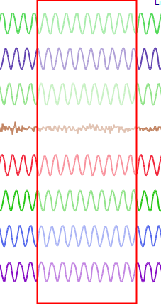

Little more advanced ...
How i can modify this code sample so that it works with multiple custom Y-axes that are vertically stacked as shown in the image below. I need to only show the series (and their custom y-axes) that is enclosed by the zoom resizable-rectagletool. If the user resizes the rectangletool, the series (and their custom axes) should also be changed in the zoomed chart.
Each of the curve in below image has a custom vertical axis.
Custom Y-axis zoom rectangle
5-13-2010 1-09-20 AM.png (34.73 KiB) Viewed 8653 times
Posts: 9701
Re: Display a portion of Fastline series
Post by Yeray » Thu May 13, 2010 11:37 am
Hi asupriya,
Then you should do something similar to the example Narcís suggested in combination to the example here.
