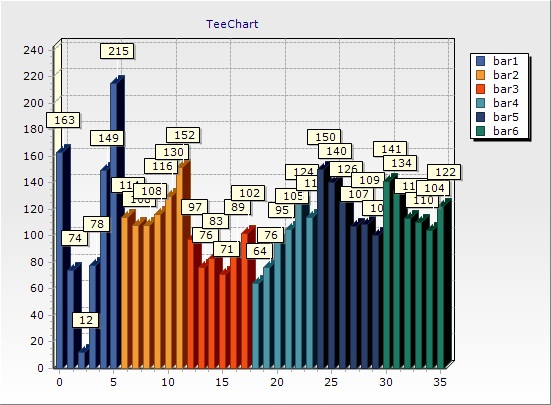

* You have reported a while ago that bar graphs with stack option set to side all works... Well, you did fix the series marks (they appear to work now). But the axis labels are totally broken. Just create 4-5 bar series, set them to SideAll and watch the labels (they are sometimes showing up under every other series, while sometimes just in random places).
I'm not able to reproduce this one or I may not understand which is the exact problem. Using the code snippet below I get this image, which is expected result for me. Is that what you get? Can you modify the code below or let us know which is the problem in the image?

* Most of my graphs with multiple series (but not all. So far I cannot tell what is the difference) have very strange legends. All of them are set to show series titles or automatic (which would be the same in this case). In the legend I have only first item to show up with the name. All other items have only symbols but nothing next to them (does it make any sense?)
This works fine for me here as you can see in the image above. Can you send a simple example we can run "as-is" to reproduce the problem here?

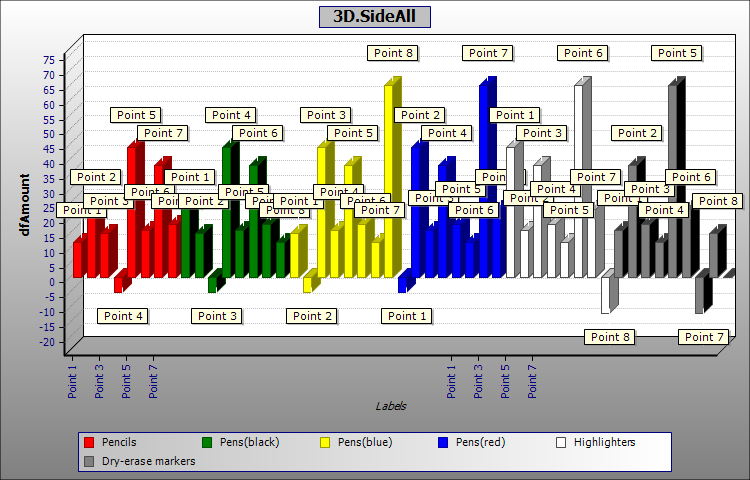

In order to see the problem with Bars set to Side All you'll need to set bottom axis to show labels (you told me that this is the system's limitation and numbers or dates will not work at all). In your example the bottom axis labels do not make any sense, so I am not sure why you even included it. Here is the example with labels:

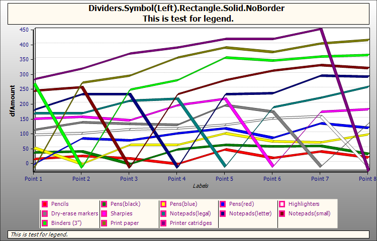

As to divider on legend, I am not sure how this works for you. Here what I am getting when I put my legend to the bottom (notice that they do not go too far down as they used to, but now they do not start at the top either):
Ok, I could reproduce this one now and added it (TF02014870) to the bug list.

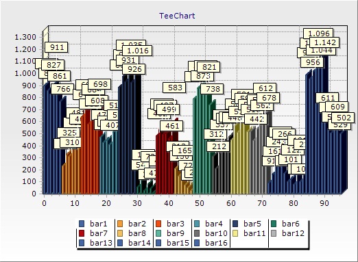

Using this code:
      for (int i = 0; i < 16; i++)
        Steema.TeeChart.Styles.Bar bar1 = new Steema.TeeChart.Styles.Bar(tChart1.Chart);
        bar1.MultiBar = Steema.TeeChart.Styles.MultiBars.SideAll;
        bar1.FillSampleValues();
      tChart1.Legend.Alignment = Steema.TeeChart.LegendAlignments.Bottom;
      tChart1.Legend.DividingLines.Visible = true;
      tChart1.Legend.Pen.Visible = false;
Produces this chart:
The only dividing line I can see here wrongly painted is the first one. Other lines may not get to the top or bottom of the legend either but this almost a one-pixel issue only. I have added this issue to the bug list too (TF02014871). If you think that in some other circumstances dividing lines go wrong please modify the code snippet above so that we can reproduce the problem here.
