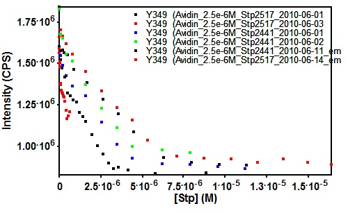

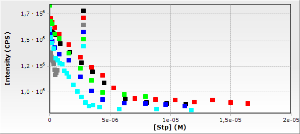

the following wrong axis scale occured:
Correct axis scaling should look like this:

What is wrong?

test_1.jpg was created with my own chart component (programmed in delphi). Since I can not use it in VB .net I decided to buy TeeChart. But your answer implies that I cannot use TeeChart until the next release since such basic scaling errors are not acceptable. Please note, that these errors are obvious in both horizontal and vertical axis. Additionally, even disabling the exponential option and using other exponential format strings do not work correctly. An empty string comes nearest to the expected (x-Axis, but also not acceptable).
As I mentioned above, with such basic scaling errors I cannot use TeeChart. So I would be glad if you could provide a workaround.

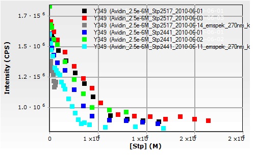

This gives me the image attached:
TF02014988 is still open and will be looked at in a future maintenance release.
Try:Uli wrote:As I mentioned above, with such basic scaling errors I cannot use TeeChart. So I would be glad if you could provide a workaround.
tChart1.Import.Template.Load(@"C:\test\test.ten");
tChart1.Axes.Bottom.Labels.Exponent = false;
tChart1.Axes.Bottom.Labels.ValueFormat = "g";
tChart1.GetAxisLabel += new GetAxisLabelEventHandler(tChart1_GetAxisLabel);
void tChart1_GetAxisLabel(object sender, GetAxisLabelEventArgs e)
if (e.LabelText.Contains("e-21")) e.LabelText = "0";

But another thing is interesting in your image log.png : I can not detect these legend items text drawn with legend font set to color.transparent (I addressed this in http://www.teechart.net/support/viewtop ... =4&t=11247). Did you go via the TChart1.Export.Image.Metafile.CopyToClipboard() function or did you save it directly to png file? In the first case I would really like to know what you have done to overcome this "ghost text" effect.
