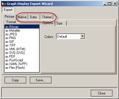

thanks for the tip. One more related question... I can hide main tabs as shown in my first post. How can i hide sub-tabs that I don't want (see the image)?
9-2-2010 10-30-39 AM.png (10.31 KiB) Viewed 6677 times
Posts: 9702
Re: Help button in Chart Editor
Post by Yeray » Fri Sep 03, 2010 3:28 pm
Hi asupriya,
If you only want the export editor you could create it directly:
            Steema.TeeChart.Editors.Export.ExportEditor exp1 = new Steema.TeeChart.Editors.Export.ExportEditor(tChart1.Chart);
            exp1.Show();
But I'm afraid it doesn't allow to hide its tabs.
I've added it to the wish list to be implemented in future releases (TF02015138)
