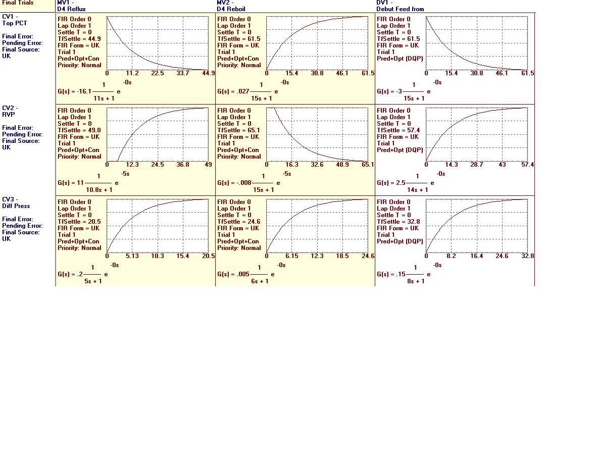

I want to use Teechart's SubChart's tool for achiving the below user interface.
Let me know if it is possible.
Query 1: Can a TeeChart tool bound to a SubChart tool. That means, i want to use Annotation tool inside a Subchart so that the annotation tool moves along with the subchart when the subchart is moved.
Please see the image below -
expected UI layout using SubChart
