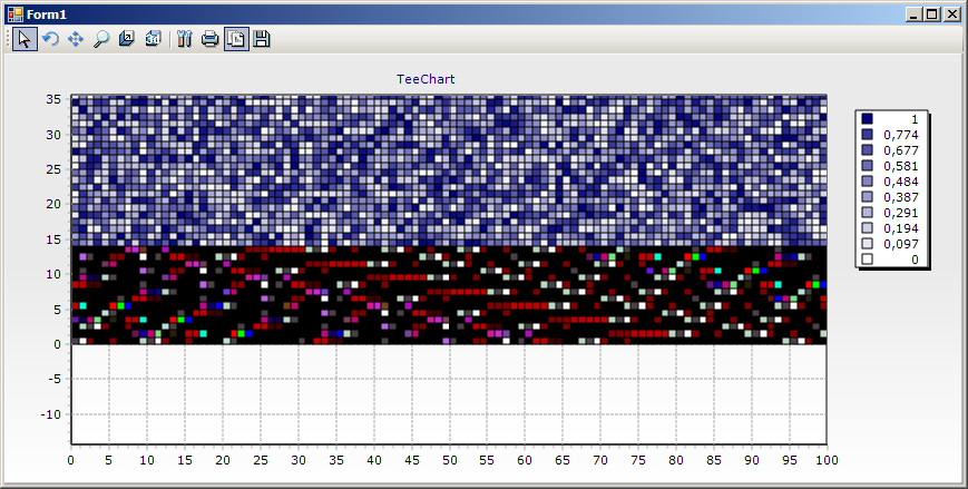

However, if I comment the line
tChart1.Axes.Left.Inverted = true;
and scroll down the chart, I can see a strange black zone. Is that what you meant?
I've added it to the defect list to be fixed in future releases (TF02015111)
