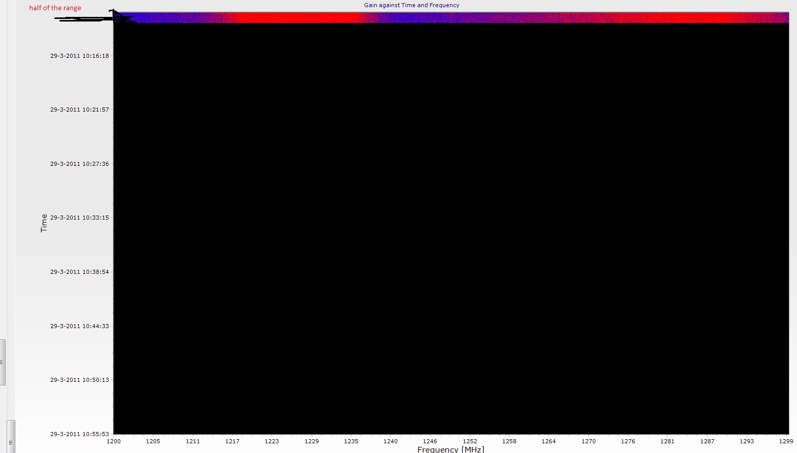

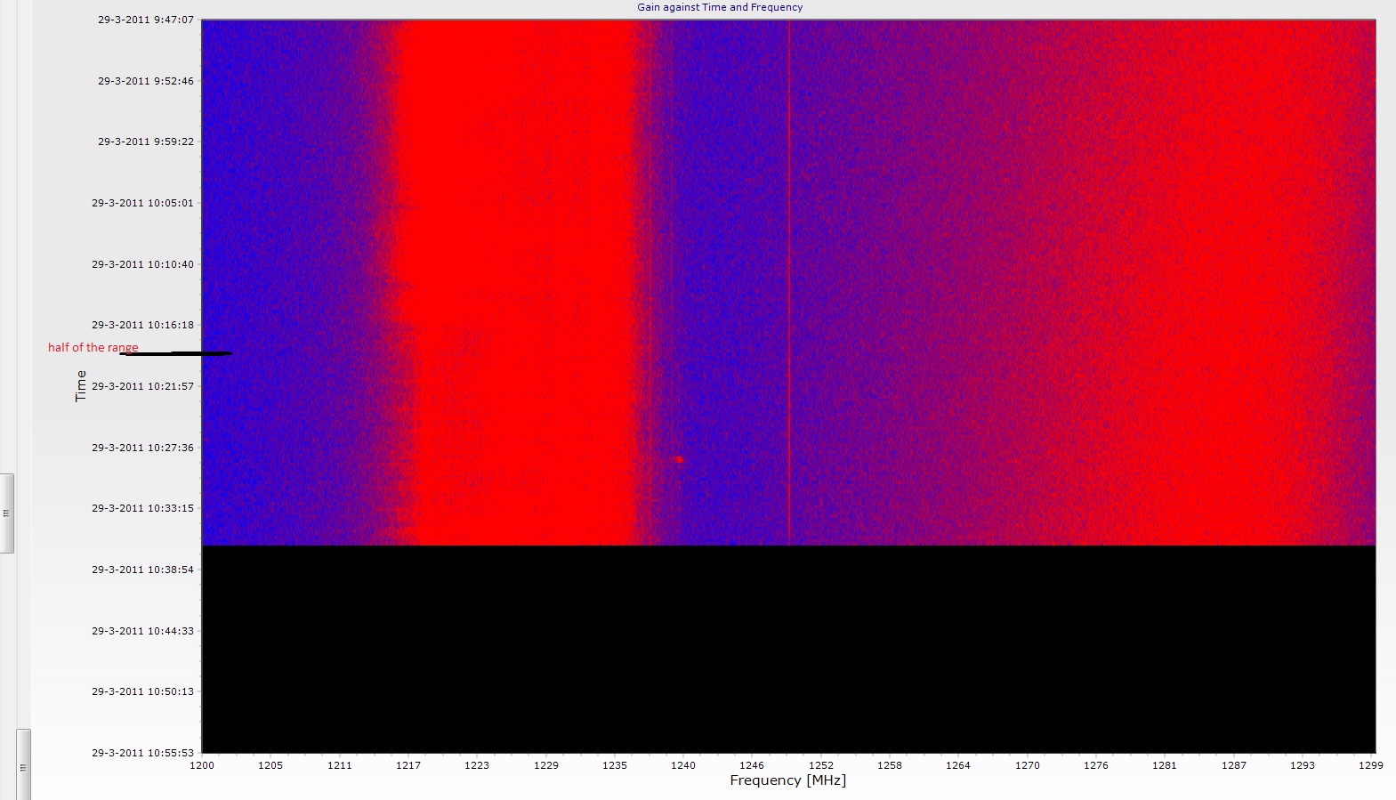

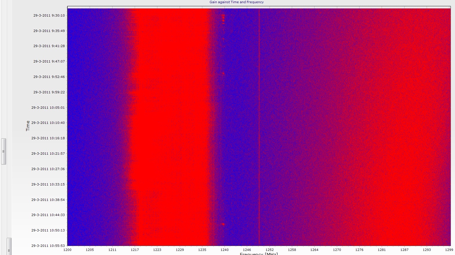

I'm currently working with a ColorGrid having quite some values, around 600000 in this example but the problem is reproductible with less values than that. When displaying the full range of the Y axis, in order to have every value displayed, everything is fine, but when trying to zoom or trying to make bigger anything under half of the Y range then the data is not displayed properly and stays black. Here are a few screenshots to make it more clear :
Initial display :
Full range, everything is fine
Reducing Y range :
Starting to reduce Y axis range, some data starts to be black
Reducing Y range more :
Reducing Y axis range, when reaching half of the range the whole displayed data is black.
When zooming anywhere under half of the range we have a similar behavior, every data being black.

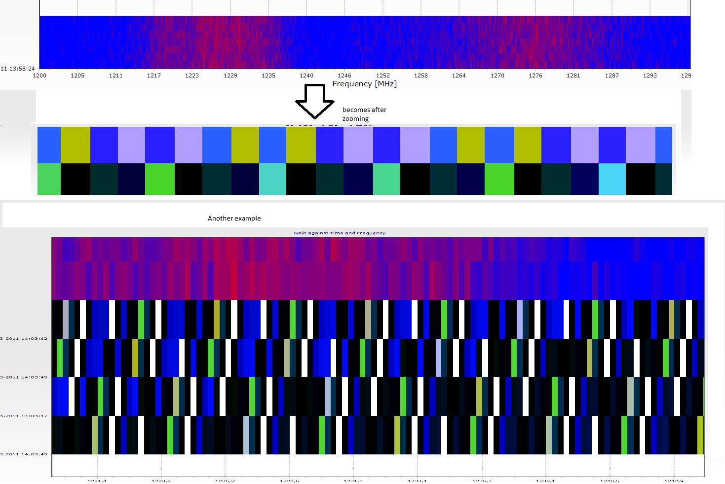

By the way, working on smaller sets of data I have a different kind of corruption, if zooming too much the color seem to be chosen randomly, if dezooming everything is back to normal. This happens both if zooming is done at the same time than updating, or at a different time.
