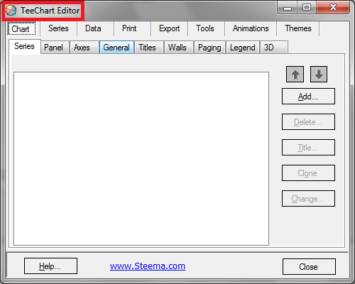

How is the Icon of the TEditor customisable ?
Re: TEditor Icon
Post by Sandra » Thu Apr 07, 2011 1:27 pm
Hello AGF,
The TEditor have the icon, you can look in red rectangle of next image:
Please, could you confirm us, if you refer the icon there is in red rectangle?

Yes, this Icon..
how can i change it to my app icon?
Re: TEditor Icon
Post by Sandra » Fri Apr 08, 2011 1:24 pm
Hello AGF,
I am afraid that it isn't possible for now and only is possible using source code of TeeChart .Net, so you could be do editors as you want as explained in this link. On the other hand, this request is known for us and is in wish-list to be considered for inclusion in future releases.
