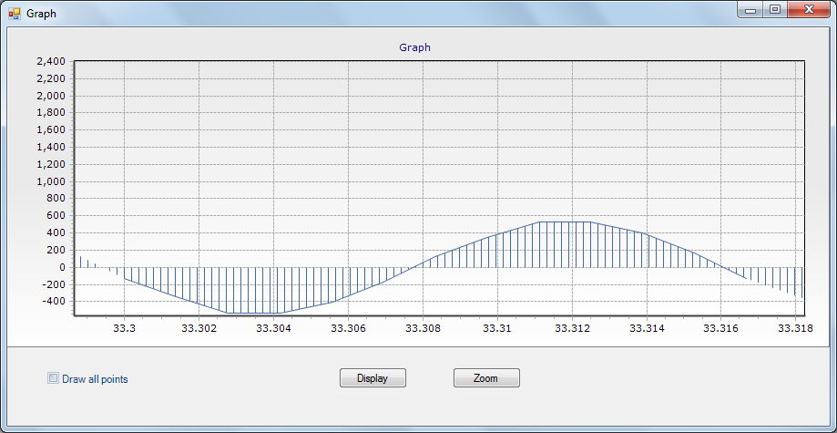

Attached is the VS2008 project with its own input data. This input data is collected at 720 samples/second (with 12 samples per cycle and a frequency of 60 cycles/sec).
The attached screenshot below shows that there are too many vertical lines drawn for 12 actual points in a cycle. My question is, how can I make sure that the vertical lines in a cycle truly correspond to the data fed to the series?
Thanks for your help.

Hi asupriya,
Thanks for the info.
The vertical lines shown in your image are those corresponding to the SeriesRegionTool brush pattern you chose:
SeriesRegionTool.Brush inherits from System.Drawing.Brush and its Style property is a System.Drawing.Drawing2D.HatchStyle enum value.
Having that in mind, System.Drawing.Brush and System.Drawing.Drawing2D.HatchStyle knows nothing from SeriesRegiontool and TeeChart series. The only option I can think of to achieve what you request is using an Area series with visible area lines, for example:
Obviously, Area series lacks the DrawAllPoints functionality. In which case you should use the DownSampling function as in the All Features\Welcome !\Functions\Extended\Reducing number of points\DownSampling Additions example at the features demo, which is available at TeeChart's program group.
srgn.Brush.Style = System.Drawing.Drawing2D.HatchStyle.Vertical

Re: FillRegion tool with sampled points
Narcis,
Area series is not a feasible solution for us. FastLine series itself is not fast enough for our data volumes and area series is out question.
One related question I have is that the issues posted herelong ago shows that the vertical lines are dependent on the series data. How is it so if the brush is not aware of the data source?
Hi asupriya,
http://www.teechart.net/support/viewtopic.php?t=4309
http://www.teechart.net/support/viewtop ... f=4&t=6590
In that case the only solution I can think is that you create your custom series inheriting from FastLine series and overriding relevant drawing methods, eg.: DrawValue method. Please bear in mind that drawing more elements into a FastLine series you'll slow it down. To improve your project's performance I strongly recommend you to read the Real-time Charting article here. If that's not enough for your needs you may also consider using TeeChart.Direct2D.dll. Last but not least, you'll find custom series examples here:Area series is not a feasible solution for us. FastLine series itself is not fast enough for our data volumes and area series is out question.
This is an issue (TF02014468) with FastLine series when DrawAllPoints is set to false and SeriesRegionTool but there's no mention that tool's brush is linked to series data. As you can see in the screen-shots in the thread you pointed at, SeriesRegionTool draws more brush pattern lines there than points are in the series, the same issue discussed in this thread.One related question I have is that the issues posted here long ago shows that the vertical lines are dependent on the series data. How is it so if the brush is not aware of the data source?
You could run this code in the Chart's OnAfterDraw event, worth checking how it fairs in performance terms. You do not need the SeriesRegion Tool in the chart to obtain the vertical lines:
Marc Meumann
private void tChart1_AfterDraw(object sender, Steema.TeeChart.Drawing.Graphics3D g)
if (tChart1[0].Count > 0)
for (int i = tChart1[0].FirstDisplayedIndex(); i <= tChart1[0].LastDisplayedIndex(); i++)
g.Line(tChart1[0].CalcXPosValue(tChart1[0].XValues[i]), tChart1[0].CalcYPosValue(tChart1[0].YValues[i]),
tChart1[0].CalcXPosValue(tChart1[0].XValues[i]), tChart1.Axes.Left.CalcYPosValue(0));
