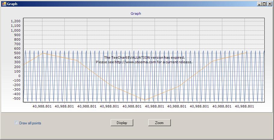

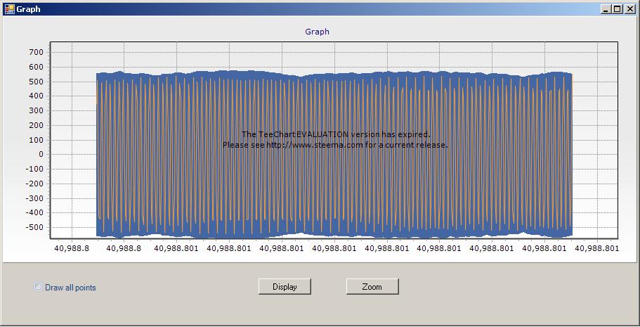

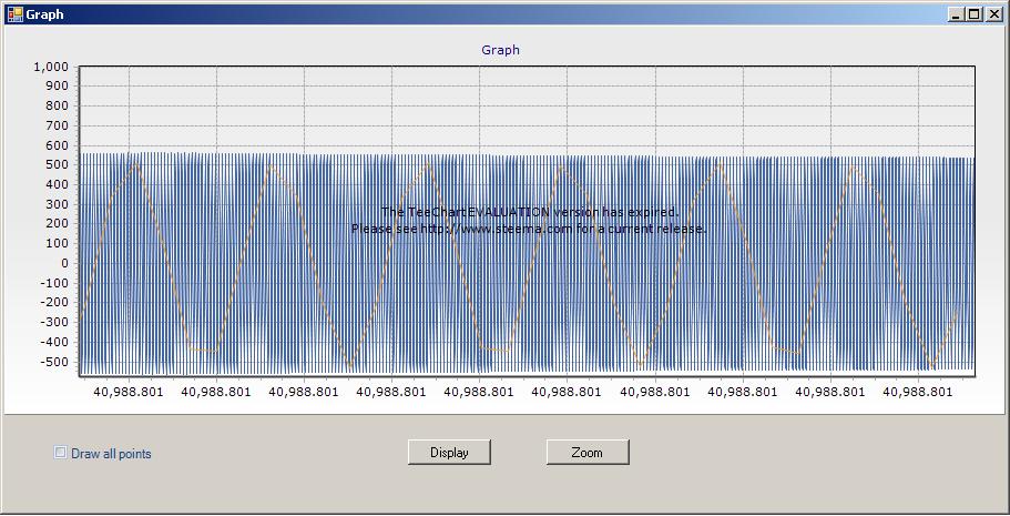

Marc, I am using evaluation 4.1.2012.02284 as it was lat installed while trying Fastline.DrawAllPointsStyle option. Do you advice retrying with latest eval version?
I am getting the screenshots as shown below. Display of both original and smoothed series.
After some zoom
Further zoom

That plot looks like an earlier version. I'm not sure if there was a recent change to this during 2012, I think not, but please use the latest build anyway just in case. Check too that the reference is correctly updated to the new teechart.dll, that your project isn't picking up an earlier version (and that an earlier assembly isn't in the GAC or set as AssemblyFolders), the screenshots do give the impression that an earlier version of TeeChart is being used.
