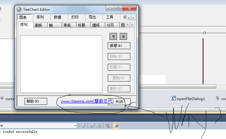

After I uninstll the old version and install the new version.(TeeChartNET2013_4.1.2013.05280.exe)
I met two problems.
1.I have bought your product,why when design my software can still see like this

Hello mingyang_203,
Could you translate to English the message there is side the http://www.steema.com within the parenthesis, because we can try to discover because it appears?
2.When the value of left axes change,and the number become like(20 to 20.152),the location of axes can not change automatic.

mingyang_203

hello,
1.That is a name of a company which is an Agents of you in china!
Because before I buy your product in your website, I download a Trial version of Teechart.NET on the agents's website.

Ok, thanks for information. Is possible you have a incorrect reference in your project or the latest version isn't installed correctly. To check it, please following my recommendations:
1.- Check if you use a correct TeeChart.dll in your project. To do it please following the steps:
- Open your project and go to Reference folder.
- Remove Teechart.dll
- Click with right button the Reference folder and add the latest TeeChart.dll. You find it in a similar path as next:
C:\Program Files\Steema Software\Steema TeeChart for .NET 2013 4.1.2013.05280
- Click with right button in the solution and choose clear solution.
- Click with right button in the solugion and choose rebuild project.
- Run your application and check that in Editor there isn't any text.
2.- You could taking a look in this thread to try to solve the problem:
On the other hand, could you tell us if you open editor in design time or in run time?

hello,
1.It's in design time,if in runtime ,can not see it.

Hello mingyang_203,
Do you do my suggestion of previous post, that consist in remove the TeeChart.dll of your project and if it doesn't work, check if you can installed correctly the TeeChartFor.Net?

I do your suggestion,but the problem still exist!I remove the teechart.dll and add the new one!

Hello mingyang_203,
Ok. We have decided to remove from the editor the label www.steema.com. Therefore, it will be fixed for next maintenance release.

Re: After I install the new version,I met problems!
Post by Sandra » Fri Jul 05, 2013 11:48 am
Hello mingyang_203,
Does it impact I distribute my software?
The impact are visible when new maintenance release are published. Anyway this change is cosmetic and doesn't effect to the correct behavior of TeeChartFor.Net. On the other hand, if you use the source code you can change the code while wait the new release. The changes I have made are in ChartEditor.cs class in next lines:

        //Is considered that linkLabel1 isn't necessary,therefore we have hidden the linkLabel. Modified by SP
        this.linkLabel1.Visible = false;

Method Load_ChartEditor:
private void ChartEditor_Load(object sender, System.EventArgs e)
#if TEELITE && POCKET
      tabControl1.TabPages.Remove(tabTools);
      tabControl1.TabPages.Remove(tabExport);
      tabControl1.TabPages.Remove(tabPrint);
	  tabControl1.TabPages.Remove(tabThemes);
      tabControl1.SelectedTab=tabChart;
#endif
      Icon = EditorUtils.TChartIcon();
      //As LinkLabel1 isn't necessary, next lines aren't necessary. Modified by SP
     /* linkLabel1.Visible = (Chart != null) && (Chart.parent != null) && (Chart.parent.GetContainer() != null);
      if (linkLabel1.Visible)*/
        bHelp.Visible = true; //linkLabel1.Visible || (HelpFileName.Length!=0);
      if (LBGroups.Visible)
        FillGroups();
