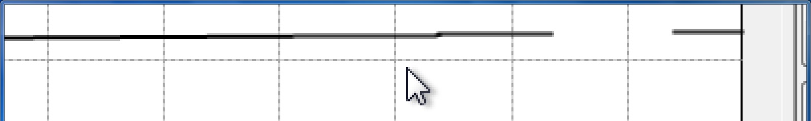

Drawing curves with FastLine and a LinePen.Width of 2 pixel it appears that some kind of anti alias
is used to draw the line.
On the enclosed screen dump this effect can be seen (magnified).
How can this be turned off, so the line will simply go up and down pixel-wise?
Thanks in advance!

I found the answer myself in the meanwhile :-)
tChart1.Aspect.SmoothingMode = System.Drawing.Drawing2D.SmoothingMode.None;
