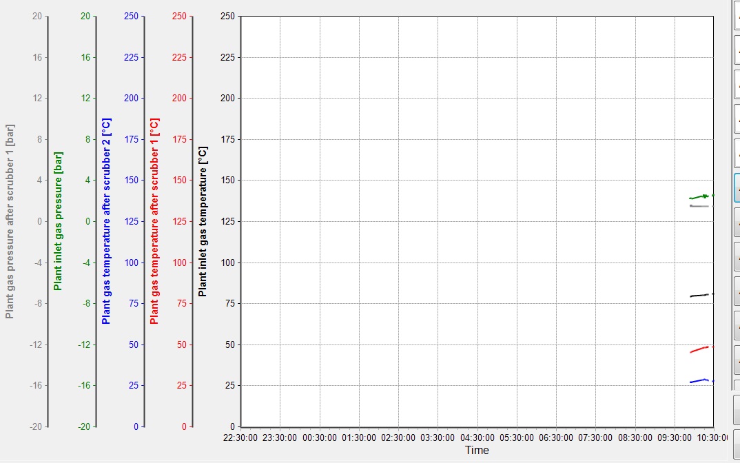

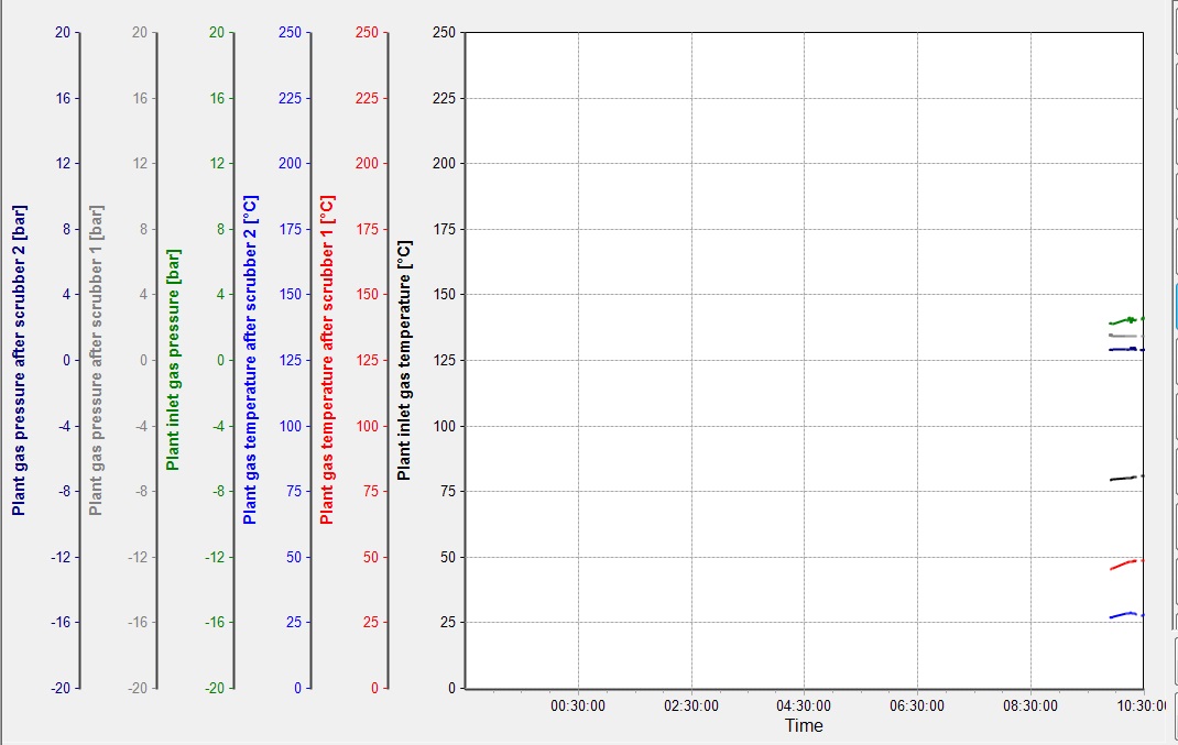

Even though tChart1.Axes.Bottom.Labels.Separation = 0 the labels with grid lines are changed automatically
as seen on the enclosed screen dumps.
The increment of the bottom axis of the chart shown on the screen dumps is set like this:
tChart1.Axes.Bottom.Increment = Utils.DateTimeStep[(int)DateTimeSteps.OneHour];
The difference between the two screen dumps is that another Y-axis was added,
and thereby the width of the chart was reduced a litte (on purpose).
In this case the labels should simply overlap, as I then intend to hide every other label in the "tChart1_GetAxisLabel" event.
How can it be that the labels and grid lines are still automatically adjusted, and how can this mechanism be turned off,
if not by setting tChart1.Axes.Bottom.Labels.Separation to 0?
Thanks in advance!
No effect with Axes.Bottom.Labels.Separation = 0;
- Would overlap, but automatic prevented.jpg (124.71 KiB) Viewed 9165 times
- Not overlapping yet.jpg (137.51 KiB) Viewed 9166 times
Re: No effect with Axes.Bottom.Labels.Separation = 0;
The only way I can think on would be to use custom labels to define the exact labels you want to show.
See the example at "All Features\Welcome !\Axes\Labels\Custom labels" in the features demo.
