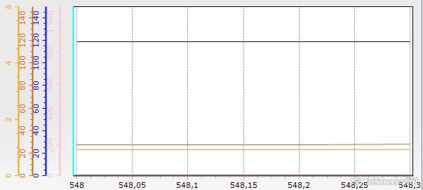

I am working with TeeChart for .net,I am creating application in C#. I would like to increase the size of drawing line(series) in the chart. presently it is drawing very thin line which is not visible for all people. How to increase size of drawing line in TeeChart.
I have attached a simple chart image from my application. I would like to draw the line with more or equal size to axis lines. presently it seems drawing line size less that axis line size. I mean i want to draw line more thick.
I have one more doubt which is
2) How to assign axis scale more reliably, I mean presently if i have axis minimum and maximum scale values from 0 to 6, then it is showing on the axis like 0,2,4,6. I would like to see like 0,1,2,3,4,5,6 like that i mean with 1 scale increment. Please help me with the above two things.
1) How to increase drawing line(series) size?
2) How to assign scale of axis more convenient?
Chart Image

1: To make lines thicker (in case of FastLine):
(tChart1.Series[index] as Steema.TeeChart.Styles.FastLine).LinePen.Width = 3;
2: Change increment for Y-axis:
tChart1.Series[index].CustomVertAxis.Increment = (tChart1.Series[index].CustomVertAxis.Maximum - tChart1.Series[index].CustomVertAxis.Minimum) / 10;
//Set division factor for whatever you need :)

Hi JohnS,
Thank you very much for you help.
