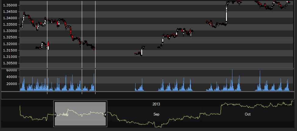

Dear Support,
I am trying to make a 15 minutes candle chart that cover multiple weeks of data and insert some axis break to hide empty spaces over weekends.
When i do this, the chart seems good at first but if I try to zoom in or pan it,the chart becomes corrupted and starts drawing series incorrectly.
Moving the chart or zooming it, peaces of series start to disappear and reappear during the mouse action, also sometime a series draw until a break and then continue drawing from the break backward.
Here is some picture to show what i mean:
Chart Look good at start: panning a bit on the left a piece of series disappear: zooming the chart and panning a bit, the series disappear in many points and in some point it draw backward: I done many tries but without success. Can you please help me to understand whats happen?

Dear Support,
I prepared i small project for you to show you the problem.
As you can see, scrolling the chart from the scroller, part of the chart disappear during scroll/zoom operation when the selection go over an empty date.
I also noticed that the problem is most visible if i modify Axes.Bottom.Minimum/Maximum manually.
Hope this could help.

Re: Chart draw strange using Axis Breaks Tool
Hello ECNSquare,
Finally I can reproduce your problem and I have added it in bug list report with number [TF02016734]. We will try to fix it to upcoming versions of TeechartFor.Net.
On the other hand, I recommend you taking a look in the TeeChart Demo project, concretely in Welcome !\Chart styles\Financial\Candle (OHLC)\Axis Labels no Weekends, where there is an example that explain as you need do to add series without weekends. I think it can help you to solve your problem.
