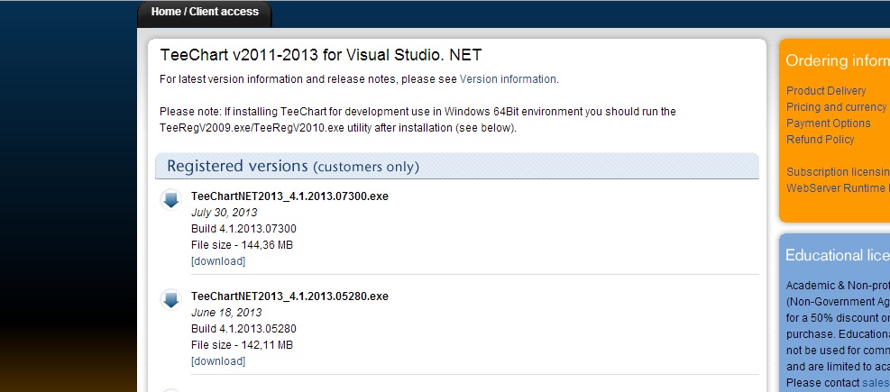

Not, it isn't the latest x64 version. Currently, we have modified multiples installer for one installer where is encapsulated all the assemblies for each Visual Studio versions and TeeChartFor.Net x64. Therefore, the last version are you need download is the latest version we have published, build number 4.1.2013.07303, as you see in next image:
