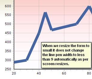

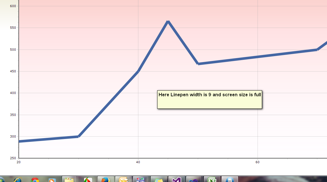

Is there is any way manage Series size, tools size ,Axis labels size,header text size when we resize the chart.
As shown in image1 with full screen.
and image2 when screen size is small.
There is any property in teechart to resize whole chart when chart size changes.

No, there's no built-in functionality for that. However, you could implement that in TChart's Resize event. You may also be interested in applying custom themes upon chart resize, see the All Features\Welcome !\Themes\Custom Themes example in the features demo, available at TeeChart's program group.

You can do something as in the example below. This example just changes the LinePen.Width property. You should do the same with other properties you'd like to change or apply a custom theme of your choice.
    private Steema.TeeChart.Styles.Line line1;
      Steema.TeeChart.Utils.UseCaches = false;
      line1 = new Steema.TeeChart.Styles.Line(tChart1.Chart);
      line1.LinePen.Width = 10;
      line1.FillSampleValues();
      tChart1.Resize += tChart1_Resize;
    void tChart1_Resize(object sender, EventArgs e)
      int w = tChart1.Width;
      int h = tChart1.Height;
      if ((w > 500) && (h > 400))
        line1.LinePen.Width = 5;
        line1.LinePen.Width = 2;
