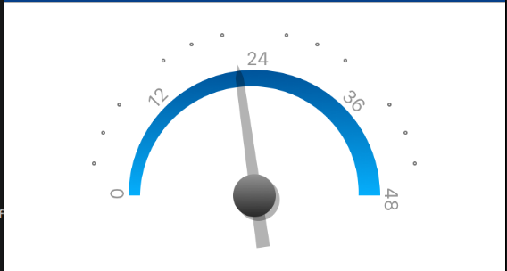

I'm creating a circular gauge in Xamarin forms, and I'm trying to change the label's color. I tried setting every property I could find, but it won't change... Can anyone help me?
this is my code: (just setting the property of the axis labels color here, because that's the one I think needs to be set... I also tried it with many other properties I found, but none are working).

In attachment the screenshot of my gauge, I want to change the color of the numbers on the axis
Thanks!

Rather than Labels.Color, which is the color of the shape around the label (the shape is invisible by default), you should change the Label.Font characteristics, e.g.
gauge.Axis.Labels.Font.Color = Color.Red;

I tried that too, and it isn't working either...

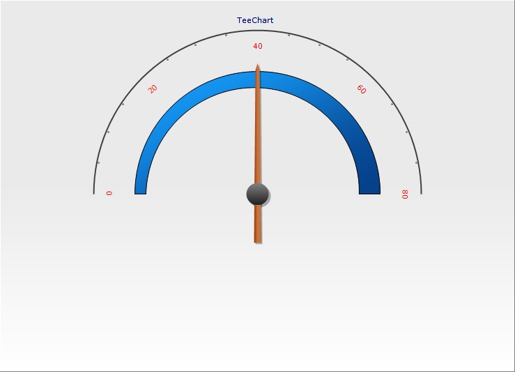

The following code works as expected with TeeChart.dll, the Windows Forms version:
      Func<int> GetCurrentValue = () =>
        return 40;
      Func<int> GetMonths = () =>
        return 80;
      CircularGauge gauge = new CircularGauge(tChart1.Chart);
      gauge.Frame.Visible = false;
      gauge.FaceBrush.Visible = false;
      gauge.DisplayTotalAngle = 180;
      gauge.TotalAngle = 180;
      gauge.Value = GetCurrentValue();
      gauge.Ticks.Visible = false;
      gauge.Minimum = 0;
      gauge.Maximum = GetMonths();
      gauge.Axis.Increment = GetMonths() / 4;
      gauge.RedLine.Visible = false;
      gauge.GreenLineStartValue = 0;
      gauge.GreenLineEndValue = GetMonths();
      gauge.GreenLine.Gradient.Direction = LinearGradientMode.ForwardDiagonal;
      gauge.GreenLine.Gradient.StartColor = Color.FromArgb(255, 6, 64, 137);
      gauge.GreenLine.Gradient.EndColor = Utils.HexToColor("FF159DFB");
      gauge.GreenLine.Pen.Visible = true;
gives me this:
Which version of TeeChart are you using?
