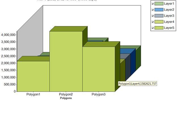

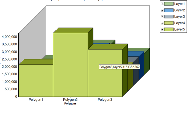

We are using .net tee chart version 2012. We are using 3D tower chart .While displaying tooltip, we are facing an issue ,if we click the series on front and top ,it show correct layer name but when we click the series on side ,it does not show correct layer name .
Image are given below for the click on front and top on series. In this image it shows series name layer5.
Image are given below for the click on side of the series. In this image it shows series name layer4.
Please suggest how we can resolve this issue.

We have been able to reproduce this issue and have added to our issue-tracking software with id=1633. A fix to this issue will be considered for inclusion into a future maintenance release.
