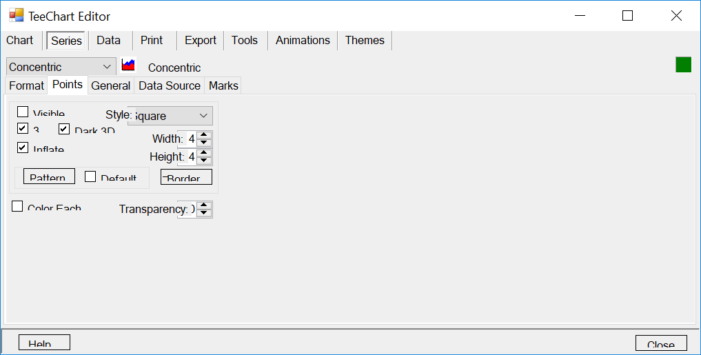

I am using VS.NET 2015 and and Steema TeeChart for .NET 2017 4.1.2017.10190. When viewing the properties pages many if not most of the buttons and other components are not displaying correctly. I have tried different screen resolutions without success. Does anyone else have this problem and any solutions?

could you please confirm if this issue is the same as the one reported here?

I seemed to have resolved the issue by reinstalling TeeChart. I think there may have been different .NET version between TeeChart.dll installed and the .NET version referenced by the application.
