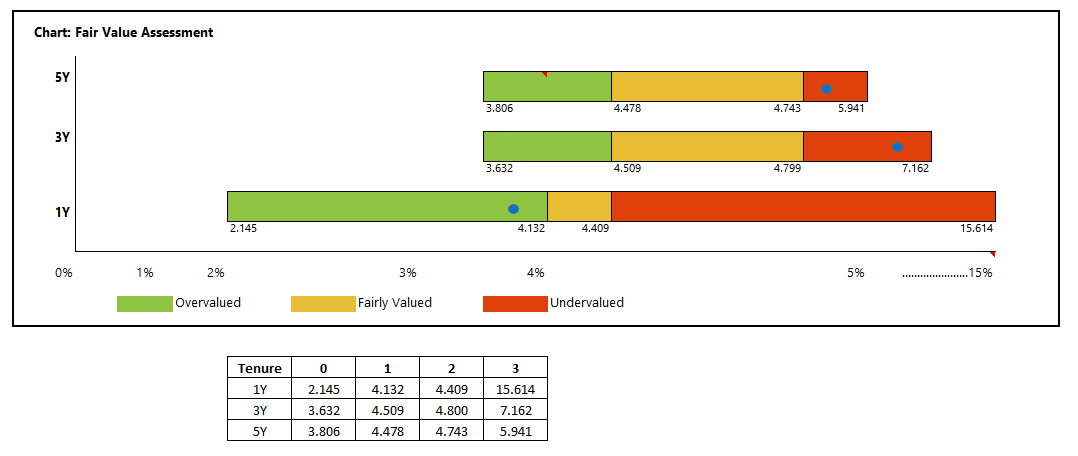

would like to know to can I set horizontal stacked bar chart as attached image.
i cant seems to get the stacked to work correctly.

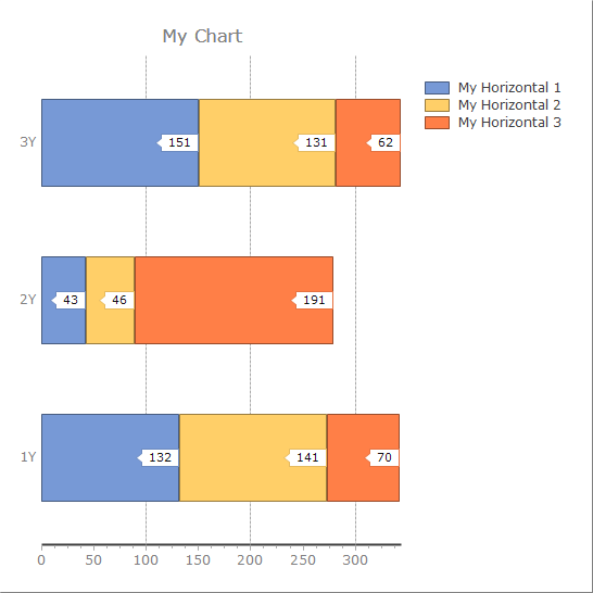

Well, some code to help you get started would be something like this:
			Random rnd = new Random();
			tChart1.Header.Text = "My Chart";
			for (int i = 0; i < 3; i++)
				HorizBar series = new HorizBar(tChart1.Chart);
				series.Title = "My Horizontal " + (i + 1).ToString();
				for (int t = 0; t < 3; t++)
					series.Add(rnd.Next(200), (t + 1).ToString() + "Y");
				series.Marks.Style = MarksStyles.Value;
				series.MultiBar = MultiBars.Stacked;
				series.MarksOnBar = true;
			tChart1.Axes.Left.Labels.Style = AxisLabelStyle.Text;
			tChart1.Axes.Left.Grid.Visible = false;
			tChart1.Axes.Bottom.Grid.Visible = true;
which gives me:

But I having issue to set the chart to start at a specific value instead of 0.
Please refer to the attachment. Thanks.

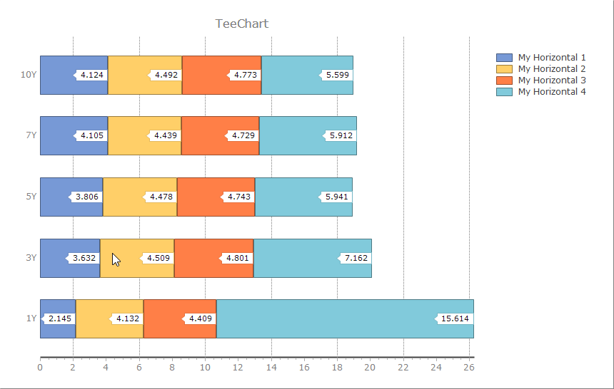

Re: Stacked Bar for Horizontal
Post by Christopher » Mon May 14, 2018 9:24 am
Hello!
Okay, well, taking your data set I've been able to come up with the following code:
			double[] YearOne = new double[] { 2.145, 4.132, 4.409, 15.614 };
			double[] YearThree = new double[] { 3.632, 4.509, 4.8008, 7.162 };
			double[] YearFive = new double[] { 3.806, 4.478, 4.743, 5.941 };
			double[] YearSeven = new double[] { 4.105, 4.439, 4.729, 5.912 };
			double[] YearTen = new double[] { 4.124, 4.492, 4.773, 5.599 };
			string[] labels = new string[] { "1Y", "3Y", "5Y", "7Y", "10Y" };
			List<double[]> years = new List<double[]>() { YearOne, YearThree, YearFive, YearSeven, YearTen };
			void AddBar(int index)
				HorizBar bar = new HorizBar(tChart1.Chart);
				bar.Title = "My Horizontal " + (index + 1).ToString();
				for (int i = 0; i < years.Count; i++)
					bar.Add(years[i][index], labels[i]);
				bar.MultiBar = MultiBars.Stacked;
				bar.Marks.Style = MarksStyles.Value;
				bar.MarksOnBar = true;
			for (int i = 0; i < 4; i++)
				AddBar(i);
This gives me the following chart:
I would suggest this chart is correct - take the "1Y" row - this correctly reflects the sum of the 1Y data (26.3) and also reflects the first data point accurately on the bar (2.145). All the rows (1Y->10Y) are correct in this sense also. Would you agree that this chart is correct? If so, what chart would you like to see if it is not this one?

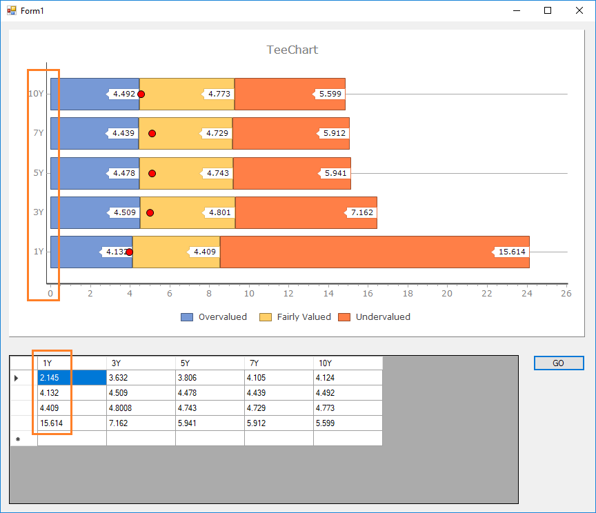

Hi Christopher, chart is incorrect. I would like to start the chart for 1Y at 2.145, 3Y at 3.3632 and 5Y at 3.806. please refer to the first image. Your sample is all starting from 0.
Post by Christopher » Mon May 21, 2018 12:22 pm
bpamit wrote:Hi Christopher, chart is incorrect. I would like to start the chart for 1Y at 2.145, 3Y at 3.3632 and 5Y at 3.806. please refer to the first image. Your sample is all starting from 0.
Yes, and this is correct if each point is a *value*.
so taking the value 2.145, the bar should end at this value, that is, the bar should end at 2.145, which is where it ends. The bar begins at zero precisely because 2.145 is a value, and all values start at zero.
Another, quite different, type of chart is where the points form a *range*. In these charts there are two points, the start point of the range and the end point of the range. So, for example, in the YearOne array above we could say there are two ranges:
2.145 -> 4.132
4.409 -> 15.614
or we could say there are three ranges:
2.145 -> 4.132
4.132 -> 4.409
4.409 -> 15.614
so the question is - are the points in the YearOne, YearTwo etc. arrays of my example *values* or *ranges*? The chart that my example drew is correct if the points are *values*. If the points are *ranges*, however, a completely different series type has to be used.

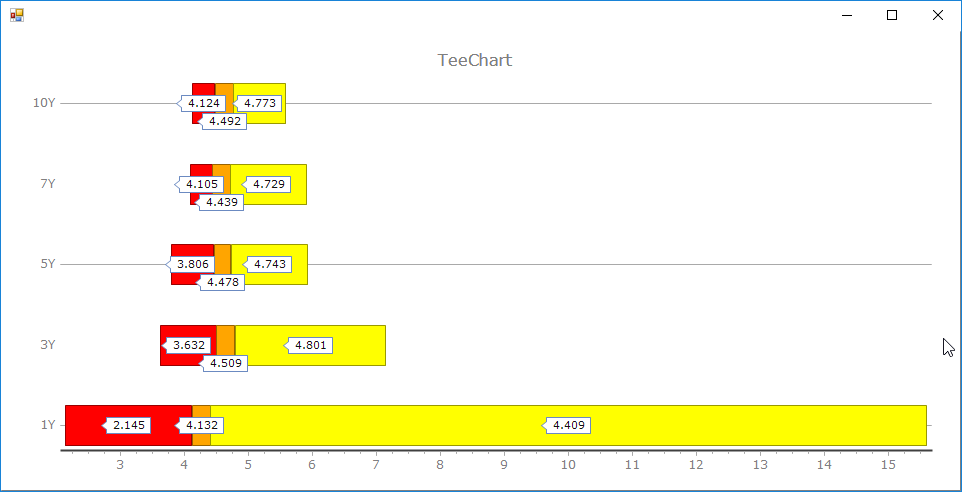

Hi Christopher, my bad. Now I understand what you mean. I would like to know which chart type to use if I need to draw bar in range.
Post by Christopher » Wed May 23, 2018 9:32 am
bpamit wrote:Hi Christopher, my bad. Now I understand what you mean. I would like to know which chart type to use if I need to draw bar in range.
No problem - one way of drawing a horizontal range chart is to use the Gantt series, e.g.
			Color[] colors = new Color[] { Color.Red, Color.Orange, Color.Yellow, Color.Green, Color.Blue };
			Gantt bar = new Gantt(tChart1.Chart);
			bar.XValues.DateTime = false;
			bar.Pointer.VertSize = 20;
			bar.Marks.Visible = true;
			tChart1.Axes.Left.MinimumOffset = 25;
			tChart1.Axes.Left.MaximumOffset = 25;
			tChart1.Axes.Bottom.Labels.Separation = 0;
			tChart1.Axes.Bottom.Increment = 1;
				double[] values = years[index];
				for (int i = 0; i < values.Length - 1; i++)
					bar.Add(values[i], values[i + 1], index, labels[index], colors[i]);
			for (int i = 0; i < 5; i++)
				AddBar(i);

Post by bpamit » Mon May 28, 2018 3:24 am
Hi Christopher, thanks for the codes. It works.
