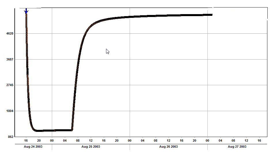

We have use TChart.Net 2012. We have XY data in which X values are in date time format. We have created a line series to plot this data in the charts. Now our requirements is that we want to display the hours in primary axis( in 24 hours format) in the bottom and date is displaying in secondary axis in the bottom of the chart. This hours labels created on the bases of date time data.
For your reference we have attached a image.
So kindly provide the solution for same.

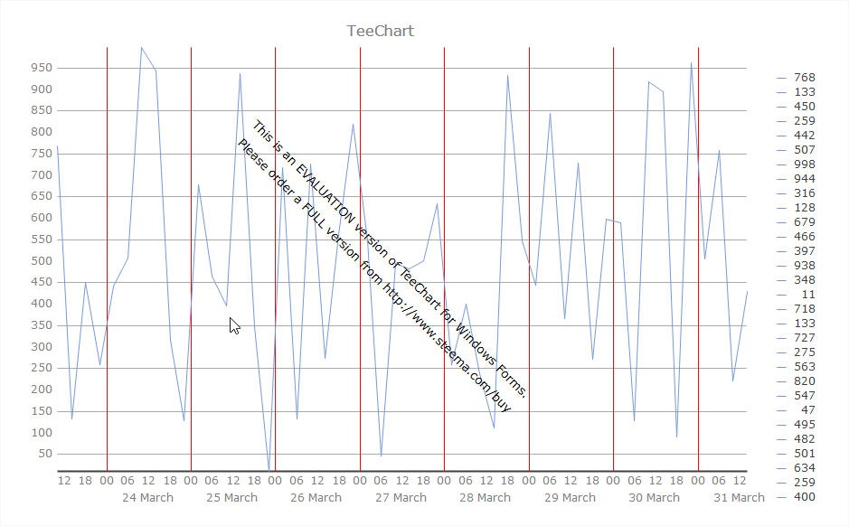

Which here gives me:
