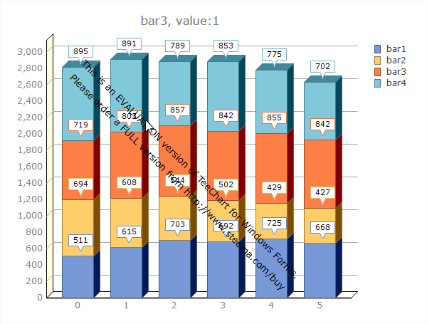

bairog
Posts: 128
Joined: Fri Dec 07, 2018 12:00 am
Re: BarSeries.Clicked() is not working correctly when stacking in 3D (.NET Framework 4.8 WinForms)
Post by bairog » Fri Oct 16, 2020 11:32 am
Your sample don't need any modification - at also have the same bug:
It still showing bar2, value:5 when cursor is already above bar3 (cyan). I need to move cursor higher to change it to bar3, value:5.
That is because component thinks that cursor is above top face of bar2 (orange) and ignores the fact that bar3 (cyan) hides that top face.
