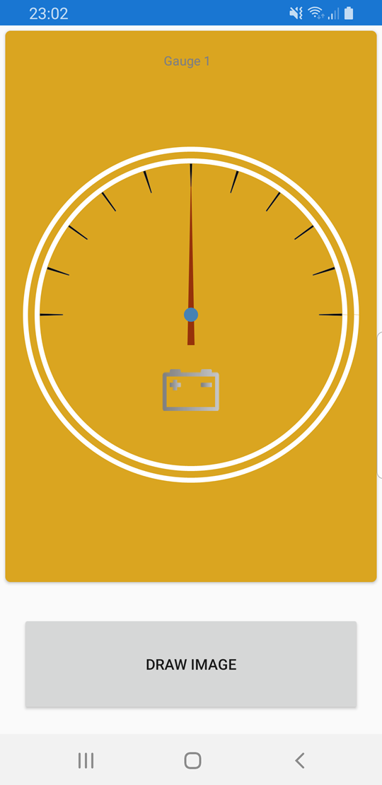

I have a requirement to draw an image on top of a circular gauge at a position relative to the gauge and for the image to scale in size when the ChartView changes size, but to keep it's position relatively within the circular gauge (chart view).
Using information from other posts in the forum, and the TeeChartNetExamples code, I use the Chart_AfterDraw event to draw the image, but my issues are...
1) How to keep the image size scaled relative to the gauge
2) How to position the image, but I would be able to do this if I could define the image size

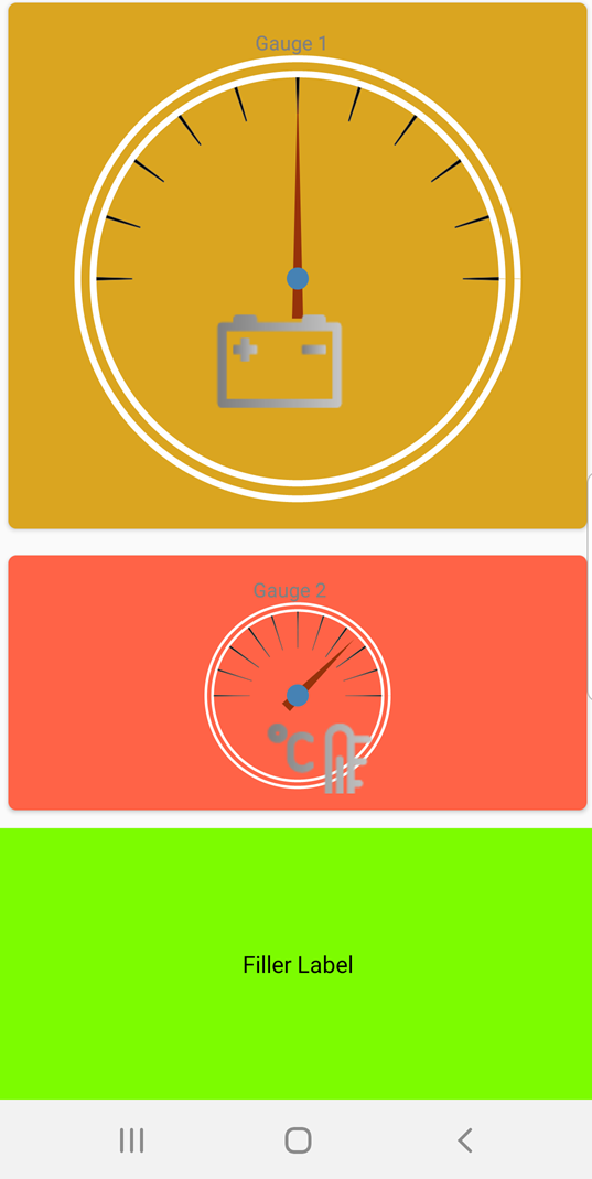

I have written a test app, showing the same user control in 2 different sizes.
Code...
public ImageSource ImageSource { get; set; }
private void Chart_AfterDraw(object sender, Steema.TeeChart.Drawing.Graphics3D g)
var img = new Image() { Source = ImageSource };
var xpos = g.ChartXCenter - (CircularGauge.XRadius / 2);
var ypos = g.ChartYCenter;
// WORKING
g.Draw(xpos, ypos, img);
// NOT WORKING
//g.Draw(new Rectangle(xpos, ypos, 12, 12), img, Steema.TeeChart.Drawing.ImageMode.Stretch, false);
I assume the solution is in one of the g.Draw overloads but I can't find the correct syntax.

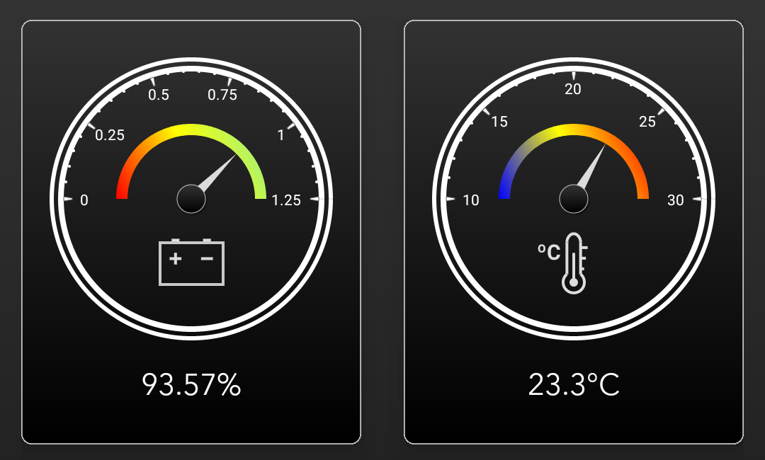

The target look is this...

just inform to you, that we're looking at it, and doing some tests in order to reproduce the problem , and we'll back to you with an answer as soon as possible.
As a question to you, what does it happens when you use the :
// NOT WORKING
Do you have a simple exmaple with which we can reproduce the problem as is ?

This new code for the thermometer graphic is excellent & far more than I expected you to provide.
I have now integrated the battery & thermometer graphic drawing code into my main App (see screenshot below) & will be able to move this into production.
Gauge Screenshot (with drawn graphics).png (69.82 KiB) Viewed 30728 times
Many thanks for your commitment in helping to resolve this issue :)
