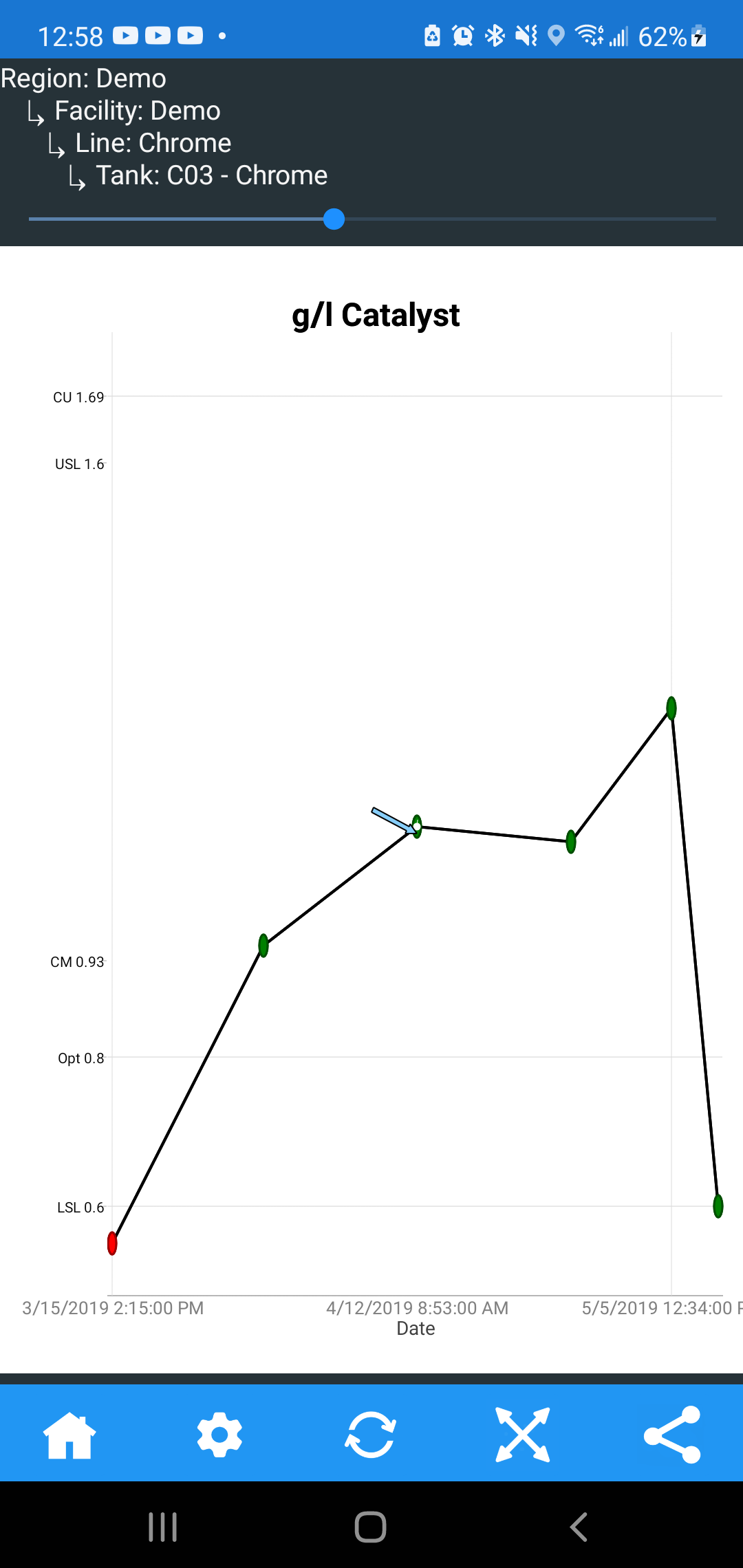

Annotation Tool Popup doesn't respect placements. Width and Height are both zero, but the bounds show correct sizing. It always renders off the screen, no matter what placement ( left ( x ), top ( y ) ) I set it to.
What is displayed:
Current settings with the above view:

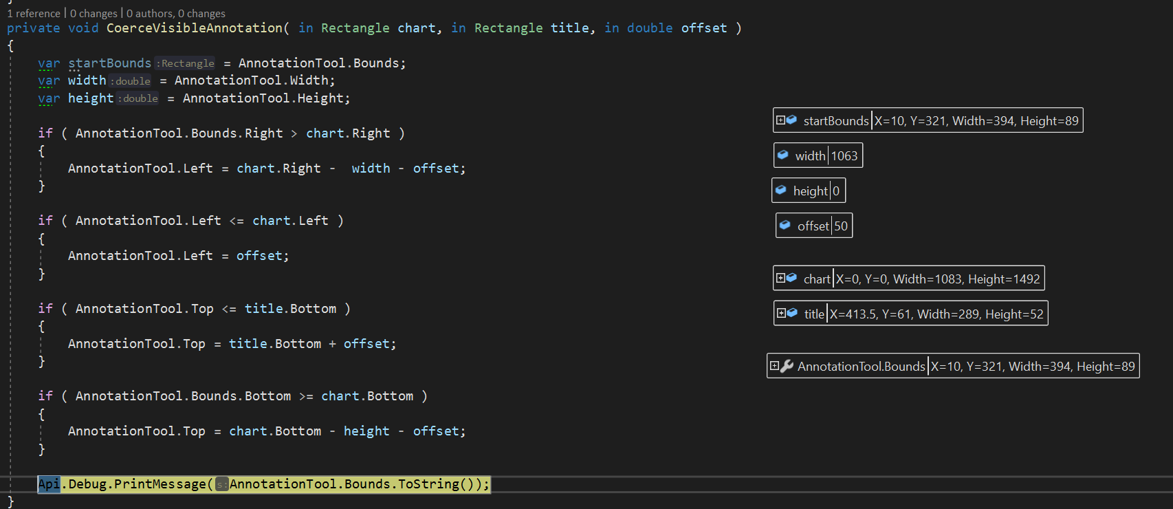

	public static void CoerceVisibleAnnotation( this Annotation tool, in Rectangle chart, in Rectangle title, in double offset )
		Rectangle startBounds = tool.Bounds;
		double width = tool.Width;
		double height = tool.Height;
		if ( tool.Bounds.Right > chart.Right ) { tool.Left = chart.Right - width - offset; }
		if ( tool.Left <= chart.Left ) { tool.Left = offset; }
		if ( tool.Top <= title.Bottom ) { tool.Top = title.Bottom + offset; }
		if ( tool.Bounds.Bottom >= chart.Bottom ) { tool.Top = chart.Bottom - height - offset; }

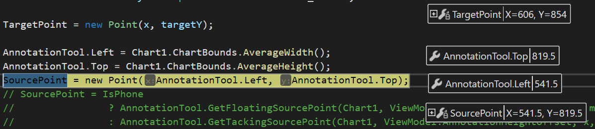

	bool leftBound = x <= Chart1.ChartBounds.AverageWidth();
	bool topBound = y <= DataLine.LocalAveragePos(out double minVerticalValueHeight, out double maxVerticalValueHeight, true);
	double targetY = topBound
						 ? y + GraphViewModel.ANNOTATION_OFFSET
						 : y - GraphViewModel.ANNOTATION_OFFSET;
	TargetPoint = new Point(x, targetY);
	AnnotationTool.Left = Chart1.ChartBounds.AverageWidth();
	AnnotationTool.Top = Chart1.ChartBounds.AverageHeight();
	SourcePoint = new Point(AnnotationTool.Left, AnnotationTool.Top);

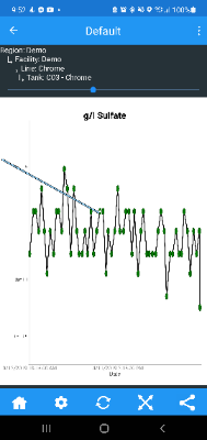

I got it to render, albeit incorrectly, by subclassing it and invoking the draw call to it. The DrawText method is NOT being called otherwise, for whatever reason.
Edit: AutoSize was being changed for some reason, somewhere. The sizing is ok.
This is a workaround:
	public class AnnotationTool : Annotation
		public AnnotationTool( Chart chart, string text ) : this(chart) => Text = text;
		public AnnotationTool( Chart chart ) : base(chart)
			Active = true;
			Position = AnnotationPositions.Custom;
			TextAlign = TextAlignment.Start;
			AutoSize = true;
			AllowEdit = false;
		public Rectangle GetBounds()
			 // forces a refresh.
			AutoSize = true;
			return Bounds;
		public void Draw( Graphics3D g ) { DrawText(g); }
	// In the graphing page, attach to the AfterDraw event
	private void TChart1_Annotations_AfterDraw( object sender, Graphics3D g )
		AnnotationTool.Draw(g);
And this is the result:
