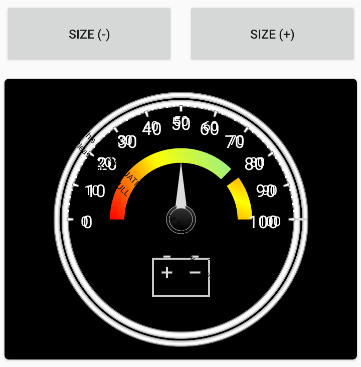

I am trying to write code to re-size aspects of a circular gauge control when the gauge itself is resized. My code does work, but only when the gauge control is pressed after being resized. I assume I am not calling my resize code in the correct event (currently calling in the AfterDraw event) but I cannot determine the best solution.
I have written a small test solution (attached) to demonstrate what I am trying to achieve.

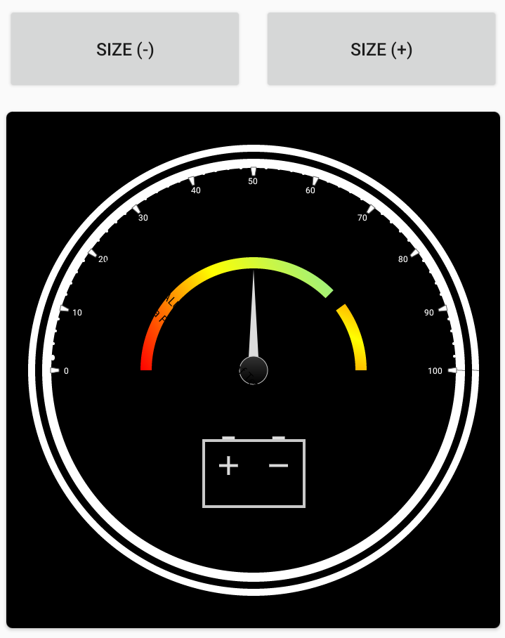

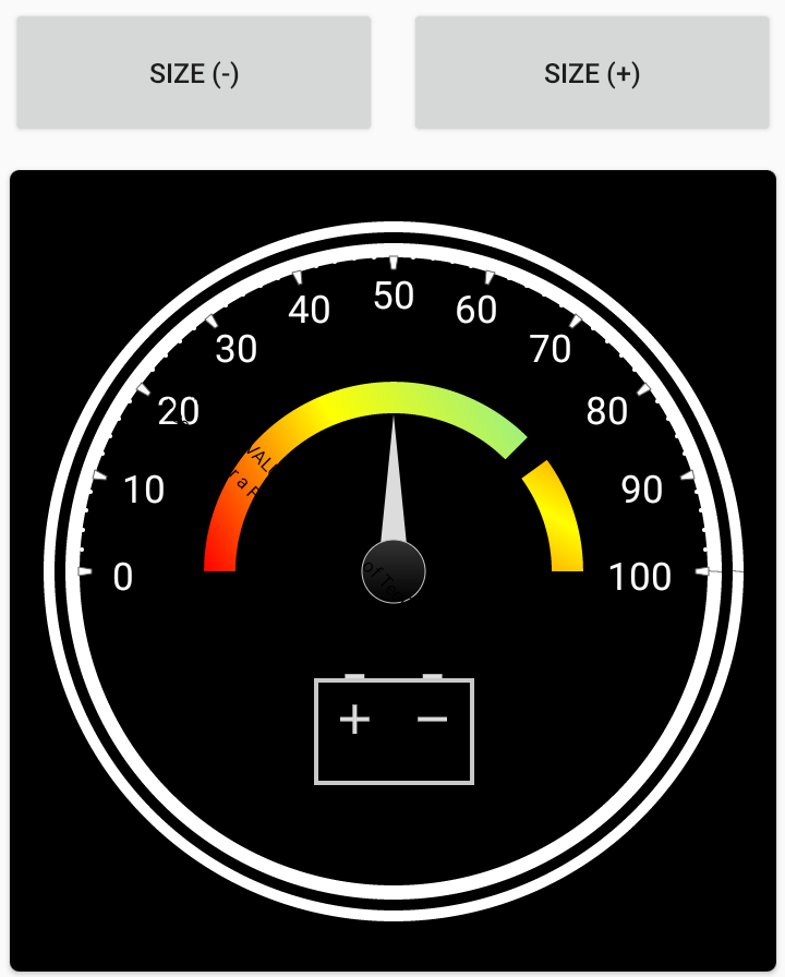

In my test App whenever the SIZE button(s) are pressed, the gauge control does resize but the label font, line band & center point only size correctly when the gauge control is subsequently pressed.
Incorrect result
Correct result (after gauge control pressed)

I have added the Chart.Chart.InternalDraw() method call to the end of the Resize method & while it does re-draw the font, centre point & colour band in the correct size it leaves the original (incorrectly sized) chart elements in position, creating a "shadow" effect - see image.
Should I be calling some sort of repaint or invalidate method before the InternalDraw method to remove the old graphics?
