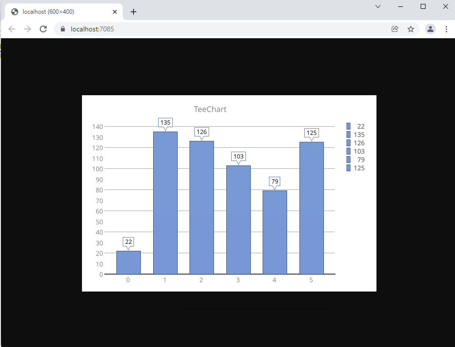

And when the TeeChart.licenses file has valid content, it gives me:
Screenshot from 2022-01-05 18-16-21.png (29.64 KiB) Viewed 19928 times

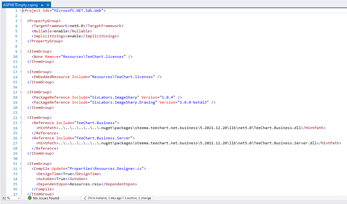

there is a problem with the licensing code in TeeChart.Business.Server.dll for .NET 6.0 - please accept our apologies for the error. However, not all is lost - you can still use TeeChart.Business.Server.dll for .NET 5.0 in the example .NET 6.0 ASPNETEmpty project, and your license will work.
To do this, please reference the assemblies directly from the NuGet package on your hard disk, which is usually located under your User - in my case it is:
C:\Users\Chris\.nuget\packages\steema.teechart.net.business\5.2021.12.20\lib\net5.0
Screenshot from 2022-01-07 17-21-25.png (17.04 KiB) Viewed 19832 times

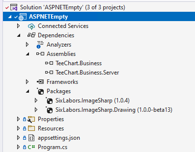

Add these two assemblies as COM references to the project - you will also need to manually install two NuGet dependencies (one of which is a beta version), namely: Which will give you:
Screenshot from 2022-01-07 17-16-18.png (16.84 KiB) Viewed 19832 times
Or:
Screenshot from 2022-01-07 17-16-58.png (100.02 KiB) Viewed 19832 times
Replacing the contents of your TeeChart.licenses file with those of the TeeChart.licenses file in the project produces an image without a watermark.
Again, apologies for the error on our part in not ensuring the compatibility of our .NET 6.0 assembly. This will be remedied as soon as possible in a new NuGet package.
