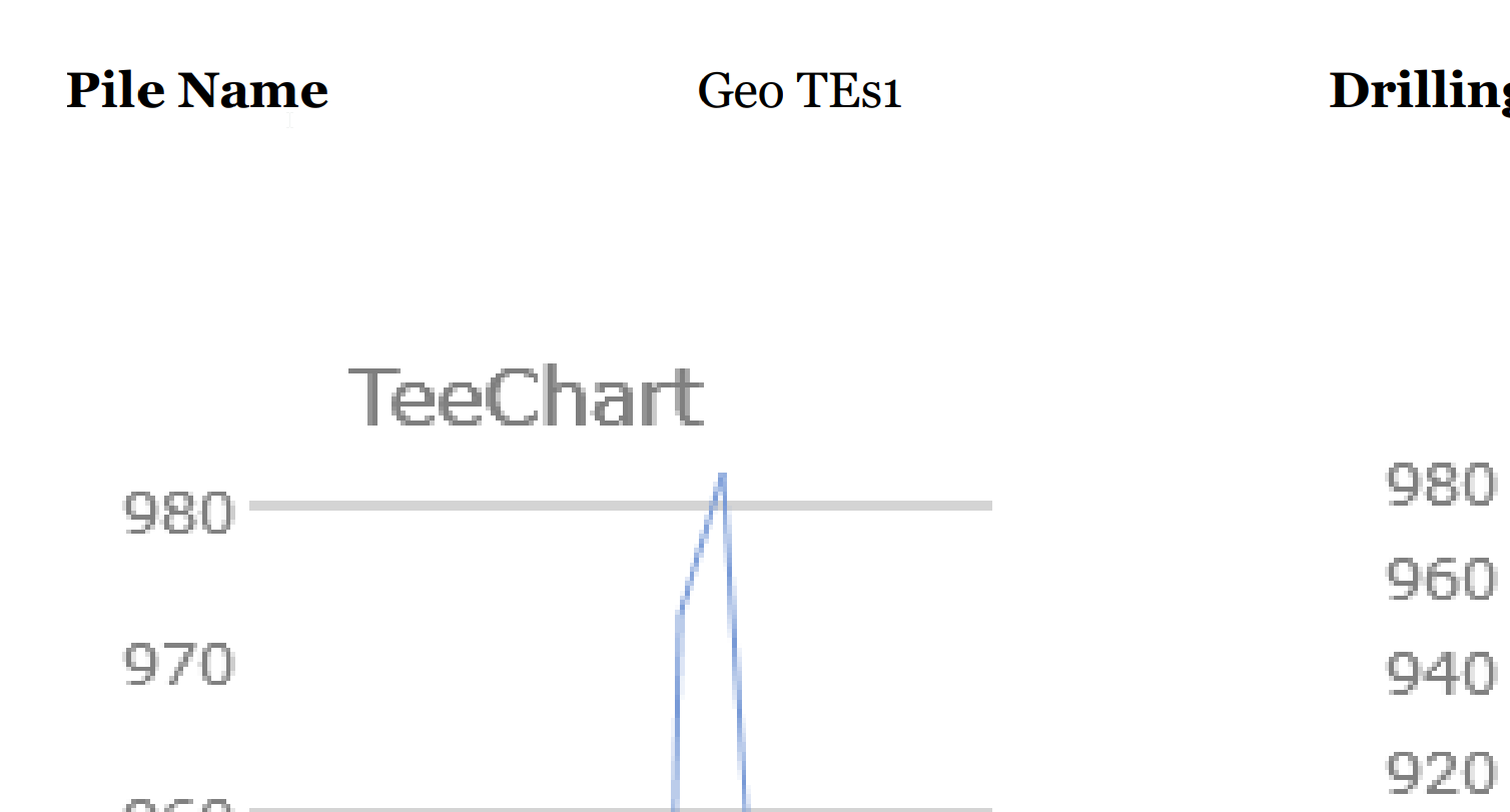

Geomisure
Posts: 10
Joined: Tue Nov 16, 2021 12:00 am
Re: [WPF] Teechart Print
Post by Geomisure » Wed Jul 27, 2022 3:29 pm
zoom in on pdf generate.
(ctrl + )
you will can see a great difference between legend text and "header text" on first line.
The same issue is obtained with a "scaling" of tchart bitmap export.
Only (worst) way to not blurry image is to printvisual from window (but it depend on window rendering and in my case it's not accepteable).
Geomisure
edit: in attachment 2 screen for better explenation
example_with bitmap_exported.png (38.24 KiB) Viewed 16324 times
Posts: 1319
Location: Girona
Post by Marc » Wed Jul 27, 2022 4:25 pm
Hello Geomisure,
I'll have a think about options. One might be to increase the resolution of the bitmap. You may need to up font sizes.
ie.
t1.Export.Image.PNG.Save(s1, t1.Bitmap((doc.PageWidth / 3 * 2), doc.PageHeight *  2), doc.PageWidth / 3, doc.PageHeight);
t2.Export.Image ...etc
Geomisure
Posts: 10
Post by Geomisure » Thu Jul 28, 2022 9:13 am
Hi Marc,
for first option it's not possible.
first size for chart.bitmap(x,y) must be the same of last 2 size parameter. otherwise image is cutted (even if you set stretchmode = fill to image)
for second option i've increased size by 1 unit and R&D manager accept this compromise, however image quality it's visibile blurry against text (an example in attach)
it's possibile to obtain an image with the same quality of metafile obtained in winforms version?
Sorry for insistence but it's the main critical section in out software and must be better quality as possible
Geomisure
document.zip
(270.61 KiB) Downloaded 978 times
