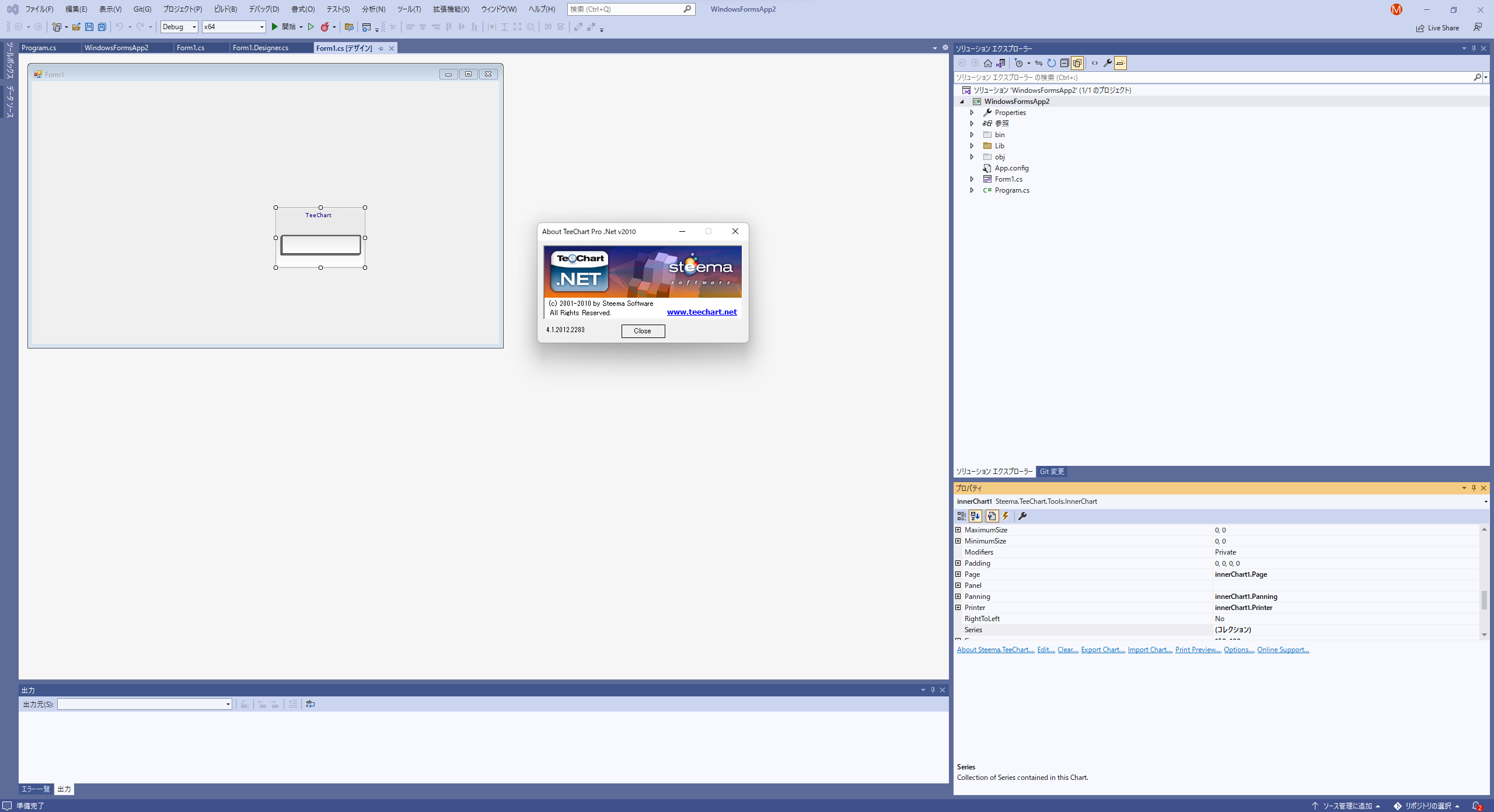

Thank you for your project. Just for your information, you can see in this image that your project works without a problem when deleting the references to TeeChart.dll and TeeChart.OpenGL.dll from your project and then adding in the latest NuGet package:

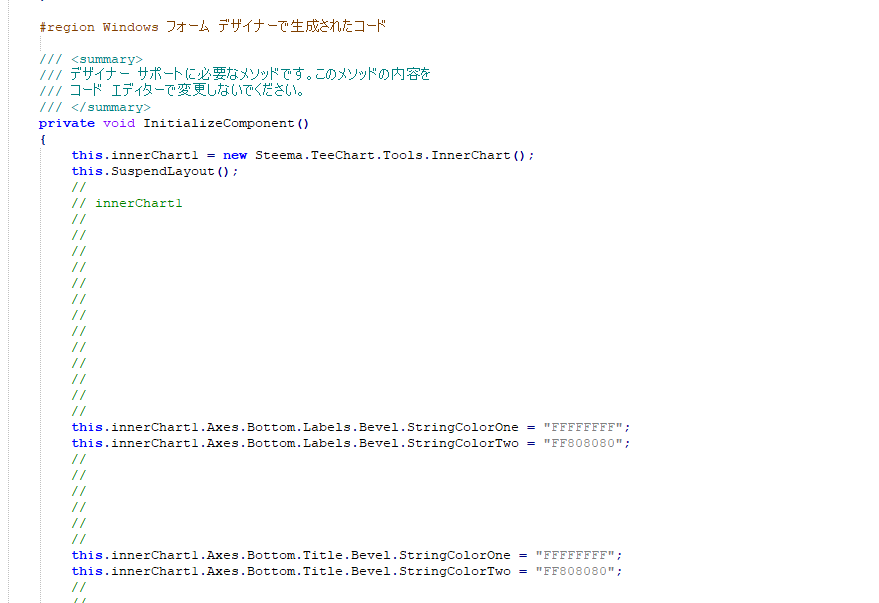

However, I see that you have an instance of the class InnerChart on the design surface of the Form:
Screenshot from 2022-08-10 13-53-15.png (27.02 KiB) Viewed 10868 times
Is this intentional? I ask because this class is essentially an internal class we use in the Tools namespace—the class which was designed to work on the design surface of a Windows Form is 'Steema.TeeChart.TChart'.

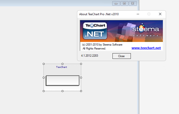

yes, you're project works fine for me here:
Screenshot from 2022-08-16 13-26-41.png (60.58 KiB) Viewed 10536 times

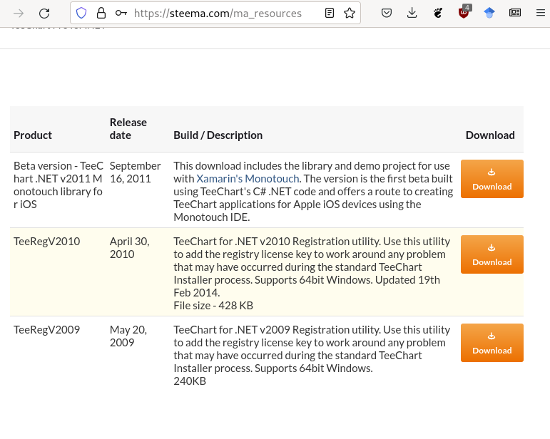

I think you should run TeeRegV2010 which will install a valid license for your v2012 version of TeeChart on your machine. You can download this executable file from the Client Access link, and then click on Resources:
Screenshot from 2022-08-16 13-33-58.png (102.49 KiB) Viewed 10536 times
Download TeeRegV2010, and then run it and follow the instructions. If you log out of your Windows User account and then log back in again, this may resolve your problem for you.

I downloaded and ran TeeRegV2010.
After running it, I can use TeeChart in VS2022.
