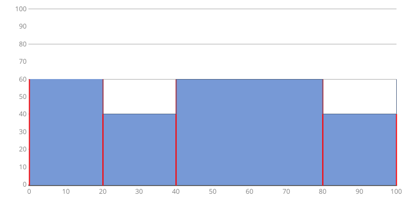

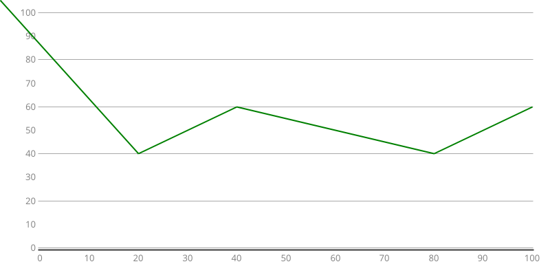

Below generated sample pictures:
Holes:
There should be stairs:
No upper red line:

thank you very much for your concise and reproducible bug report. I have added these issues as separate ones in our issue tracker with id=2571, id=2572, and id=2573. As soon as we have mitigated these errors we will let you know.

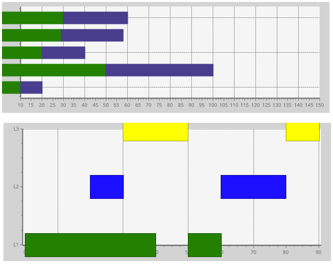

I checked the setting you recommended (mChart.Aspect.ClipPoints = false) and it actually fixed the line and the stairs area series. Unfortunately, it is not a universal solution because it causes other types of series that I use to be painted incorrectly, e.g. HorizBar and Gantt, causing them to display outside the Chart axes.
I look forward to seeing you fix the reported issues.
