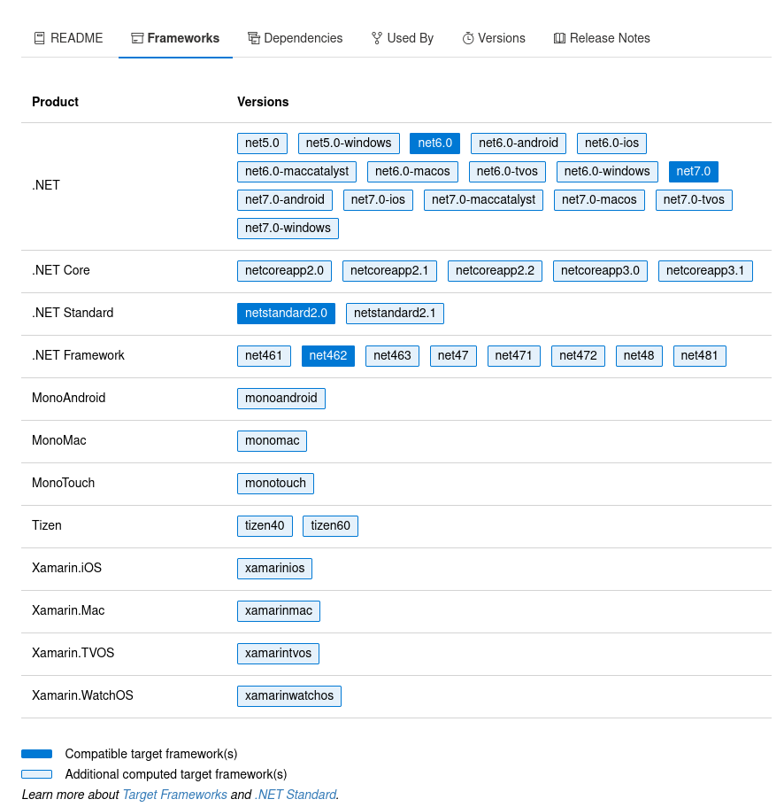

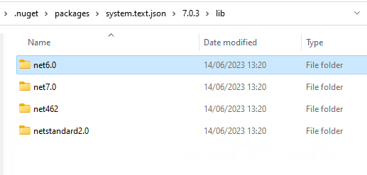

2. System.Text.Json is referenced in version 7.0.2. This looks like using api of net7 which is not the target platform. Wouldn't it be sufficient to reference version 6.0.x?
System.Text.Json v7.0.3. is built for net6.0, as you can see both in the nuget package itself:
Screenshot from 2023-06-19 16-19-52.png (16.82 KiB) Viewed 42235 times
And in the documentation on its NuGet page:
Screenshot from 2023-06-19 16-22-02.png (93.38 KiB) Viewed 42235 times
I cannot see any technical reason for believing that this NuGet is incompatible with net6.0, or that it was designed exclusively for use in net7.0
