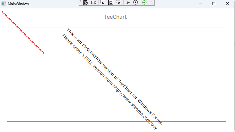

here's a small example:
    public partial class MainWindow : Window
        private TChart _tChart1 = new TChart();
        public MainWindow()
            grid1.Children.Add(_tChart1);
            _tChart1.AfterDraw += _tChart1_AfterDraw;
        private void _tChart1_AfterDraw(object sender, Steema.TeeChart.Drawing.IGraphics3D g)
            g.Pen.Color = System.Drawing.Color.Red;
            g.Pen.Width = 3;
            g.Pen.Style = Steema.TeeChart.Drawing.DashStyle.DashDot;
            g.MoveTo(10, 10);
            g.LineTo(150, 150);
which here gives me:
Screenshot from 2023-07-28 12-10-07.png (33.95 KiB) Viewed 17046 times
