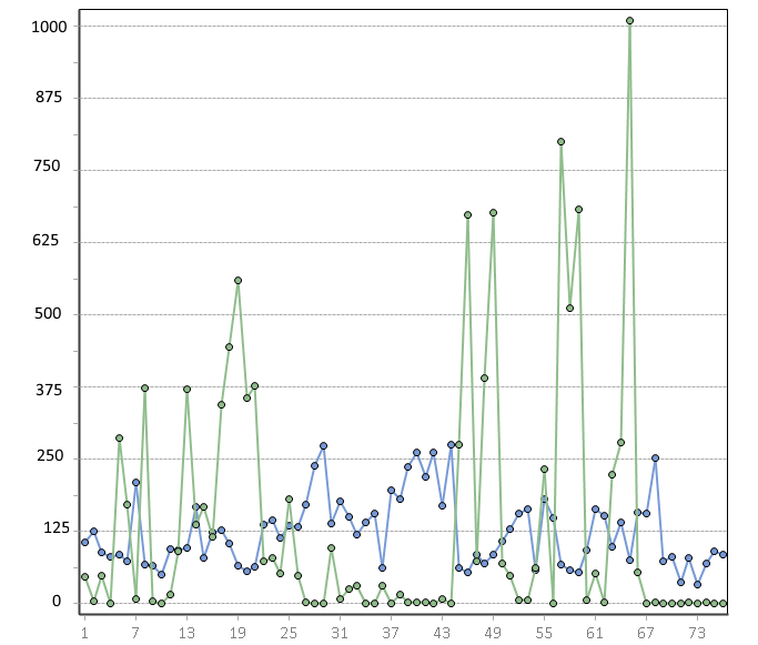

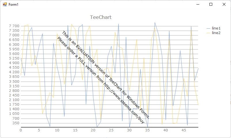

I need to make automatic labels of the left axis be a multiple of 125. And ensure horizontal gridlines to be drawn for every label.
So that my chart would look something like this (depending on the actual Y values):

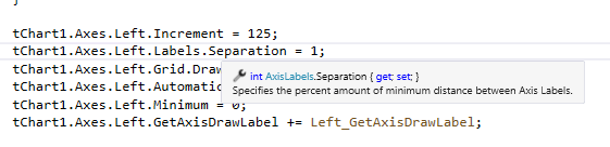

Thank you. That is exactly what I need. Only one question left: what does tChart1.Axes.Left.Labels.Separation = 1; stand for? I see no changes on a chart when adjusting that value (I've tried 2, 3, 5 and 10).

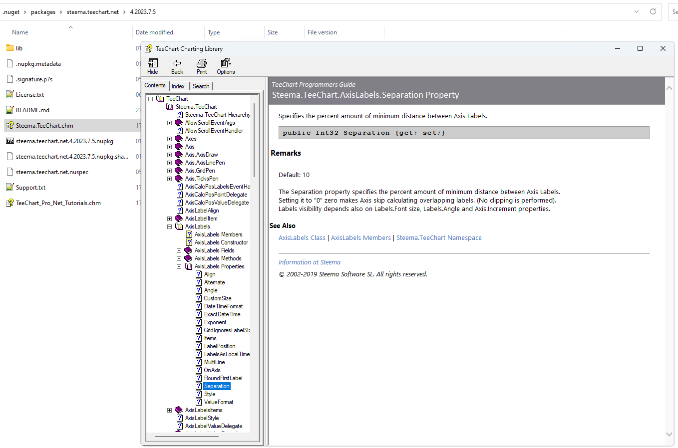

I guess you have a TeeChart.xml file. Could you share it so I don't have to go online every time I need a property description. Thank you.
Re: Howto make automatic labels of the left axis be a multiple of some value
Post by Christopher » Wed Aug 02, 2023 7:48 am
There's a Steema.TeeChart.chm file shipped in the TeeChart NuGet packages which has the xml documentation compiled into it. This is what we would suggest you use for 'offline' API documentation.

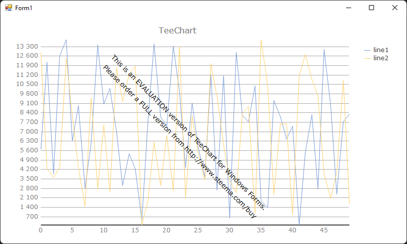

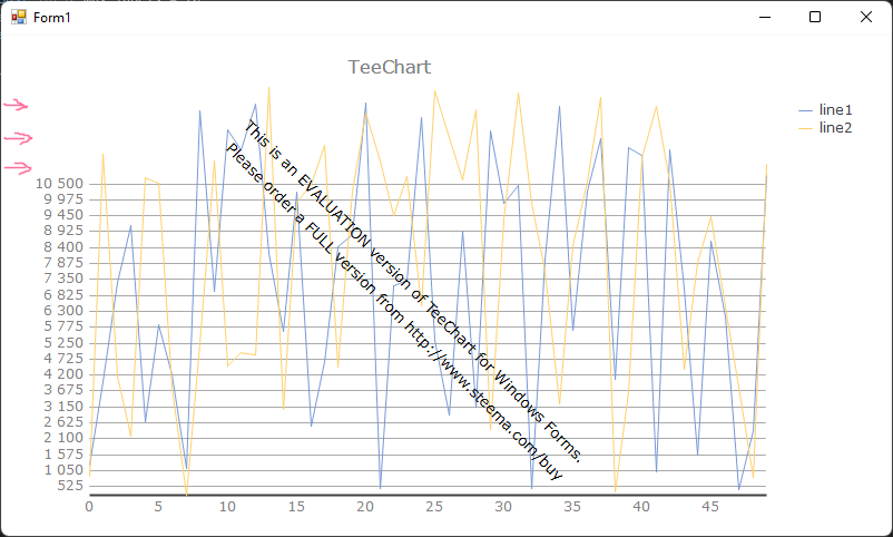

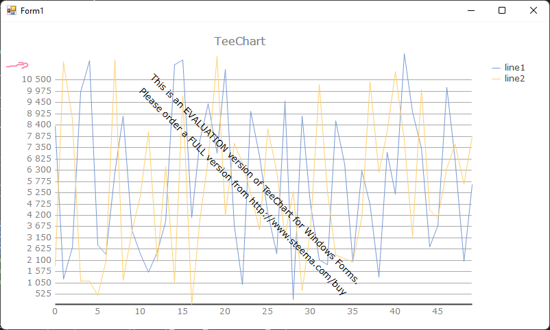

I have done further testing and found that your code does not always work correctly. I you change 125 to 350 and set max = 8000 - it is ok:
But you set max = 9000 (and more) - most labels are not multiples of 350:
I've expected auto labels to be set to a multiple of 350 (for example 0, 1750, 3500, 5250, 7000 and 8750). Are there any workarounds?

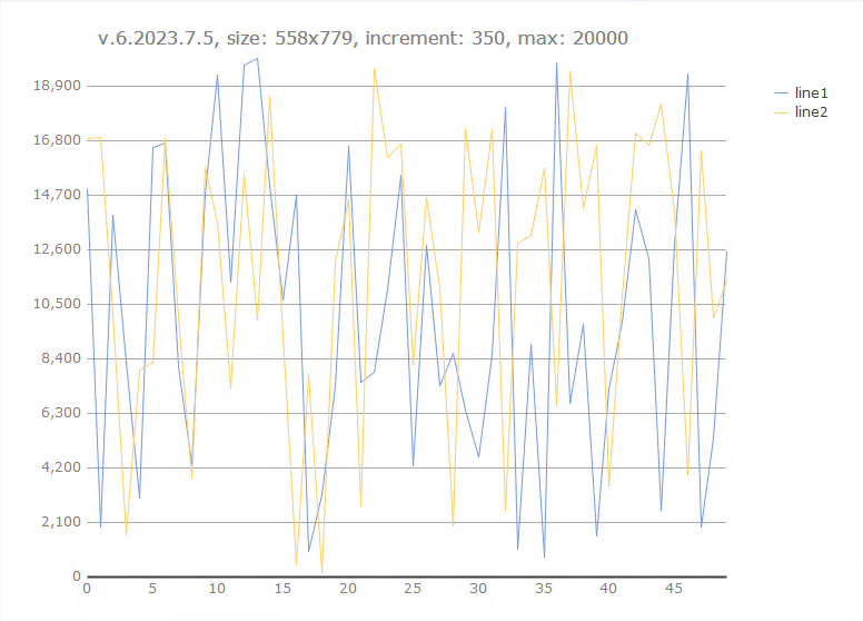

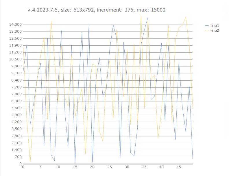

for finer control, you can use the GetNextAxisLabel event, e.g.
        const int _increment = 350;
        const int _max = 20000;
            var line1 = new Line(tChart1.Chart);
            var line2 = new Line(tChart1.Chart);
            var rnd = new Random();
            for (int i = 0; i < 50; i++)
                line1.Add(rnd.Next(_max));
                line2.Add(rnd.Next(_max));
            tChart1.Axes.Left.Increment = _increment;
            tChart1.Axes.Left.Grid.DrawEvery = 1;
            tChart1.Axes.Left.AutomaticMinimum = false;
            tChart1.Axes.Left.Minimum = 0;
            tChart1.GetNextAxisLabel += TChart1_GetNextAxisLabel;
        protected override void OnResize(EventArgs e)
            base.OnResize(e);
            tChart1.Header.Text = $"v.{Utils.Version}, size: {tChart1.Height}x{tChart1.Width}, increment: {_increment}, max: {_max}";
        private void TChart1_GetNextAxisLabel(object sender, GetNextAxisLabelEventArgs e)
            var multiplier = Utils.Round(tChart1.Axes.Left.Maximum / _increment / 10);
            int GetValue(int index)
                return _increment * multiplier * index;
            if (sender == tChart1.Axes.Left)
                e.Stop = false;
                switch (e.LabelIndex)
                    case 0: e.LabelValue = 0; break;
                    case 1: e.LabelValue = GetValue(1); break;
                    case 2: e.LabelValue = GetValue(2); break;
                    case 3: e.LabelValue = GetValue(3); break;
                    case 4: e.LabelValue = GetValue(4); break;
                    case 5: e.LabelValue = GetValue(5); break;
                    case 6: e.LabelValue = GetValue(6); break;
                    case 7: e.LabelValue = GetValue(7); break;
                    case 8: e.LabelValue = GetValue(8); break;
                    case 9: e.LabelValue = GetValue(9); break;
                    default: e.Stop = true; break;
Screenshot from 2023-08-03 09-50-40.png (261.52 KiB) Viewed 154252 times

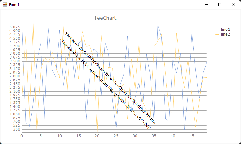

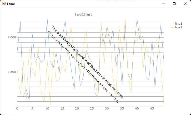

Your code is not working very well when _max / _increment is close to a multiple of max_labels but is slightly less.
In your specific example (max_labels = 20 and _increment = 175) you can just set _max = 13900 (13900 / 175 = 79.428) and get the following picture (there is a big gap between the last label and left axis actual maximum):
I have tested some workarounds and the best I have come up with is changing _multiplier formula from Utils.Round(_max / _increment / _num) to (Int32)Math.Round((Double)_max / _increment / _num). With this approach, a greater multiplier is chosen in 50% cases.
So the situation I've decribed (max_labels = 20, _increment = 175 and _max = 13900) becomes:
My approach is not always perfect: when (Double)_max / _increment / _num is close to n.5 but slightly less there is same gap (but it is 2 times smaller). For example for _max = 12200 (12200/175/20 = 3.485, so _multiplier is still 3) I get the following picture:
If you have any ideas how to further improve my adjusted algorithm - please share it. Thank you.

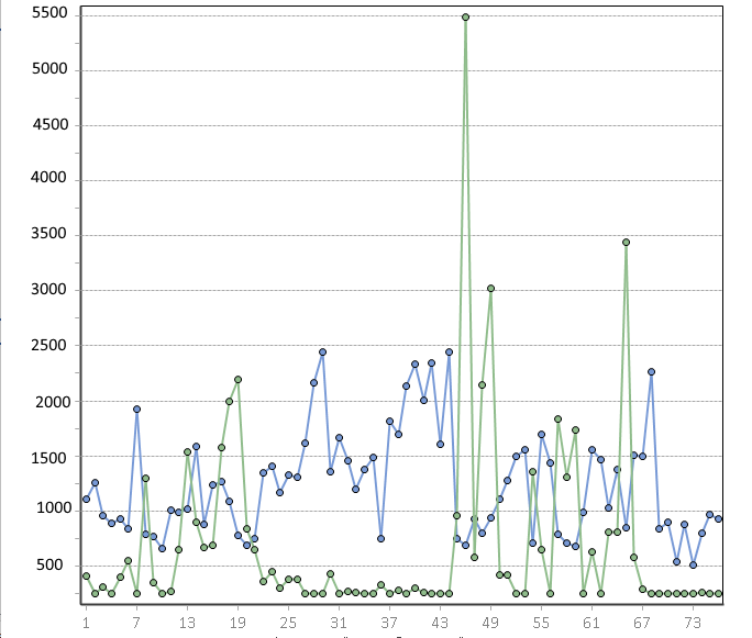

Unfortunately with this code labels count can greatly exceed max_labels value. For example for _max = 5300 the are 30 labels:
