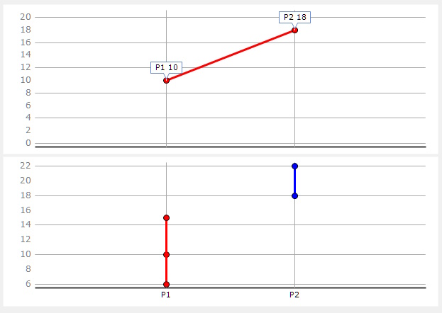

Not sure, I thought I had understood correctly. That the goal is to line up the charts (?). The principle is the same in this case. To modify chart settings to obtain the required result.
ie.
Very unrefined code to achieve these charts is included here:
Line line1;
Line line2;
Line line3;
    line1 = new Line(tChart1.Chart);
    line2 = new Line(tChart1.Chart);
    line3 = new Line(tChart2.Chart);
    var product1 = "P1";
    var product2 = "P2";
    InitializeChart(line1, product1, Color.Red);
    InitializeChart(line2, product2, Color.Blue);
    InitializeChart2(line3,Color.Red);
    line3.Add(0, 10, "P1");
    line3.Add(1, 18, "P2");
    line3.Marks.Visible = true;
    line3.Marks.Style = MarksStyles.LabelValue;
    tChart2.Legend.Visible = false;
    tChart1.Axes.Bottom.SetMinMax(-1, 2);
    tChart1.Axes.Bottom.Grid.DrawEvery = 1;
    tChart2.Axes.Bottom.SetMinMax(-1, 2);
    tChart2.Axes.Bottom.Grid.DrawEvery = 1;
    tChart2.Axes.Left.SetMinMax(0, 20);
    tChart1.Axes.Left.Labels.Size.Width = 10;
    tChart1.Axes.Bottom.Labels.Items.Add(0, product1);
    tChart1.Axes.Bottom.Labels.Items.Add(1, product2);
    tChart2.Axes.Bottom.Labels.Items.Add(0, "");
    tChart2.Axes.Bottom.Labels.Items.Add(1, "");
    tChart2.Axes.Bottom.Labels.Visible = false;
    tChart1.Axes.Bottom.Grid.Visible = true;
    tChart2.Axes.Bottom.Grid.Visible = true;
public class ProductInfo
    public string Product { get; set; }
    public int Y { get; set; }
    public int X { get; set; }
List<ProductInfo> list = new List<ProductInfo>()
    new ProductInfo() { X = 0,  Product = "P1", Y = 10 },
    new ProductInfo() { X = 0, Product = "P1", Y = 15 },
    new ProductInfo() { X = 0, Product = "P1", Y = 6 },
    new ProductInfo() { X = 1, Product = "P2", Y = 22 },
    new ProductInfo() { X = 1, Product = "P2", Y = 18 }
private void InitializeChart2(Line line, Color color)
    line.LinePen.Width = 3;
    line.Color = color;
    line.Pointer.Visible = true;
    line.Pointer.Style = PointerStyles.Circle;
private void InitializeChart(Line line, string select, Color color)
    line.Color = color;
    line.YValues.DataMember = "Y";
    line.XValues.DataMember = "X";
    line.LabelMember = "Product";
    line.Title = select;
    line.Add(list.Where(x => x.Product == select).ToList() as IList);
private void tChart2_GetAxisLabel(object sender, GetAxisLabelEventArgs e)
    if (((Axis)sender).Horizontal)
        e.LabelText = "";

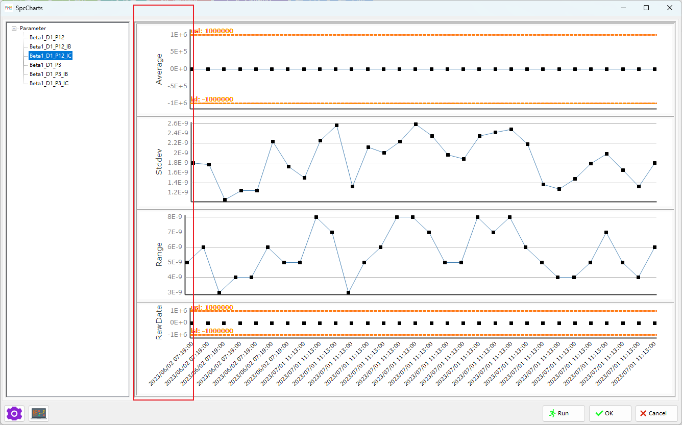

Question1:How do I find the maximum distance to the left of four graphs and set this maximum distance for all graphs

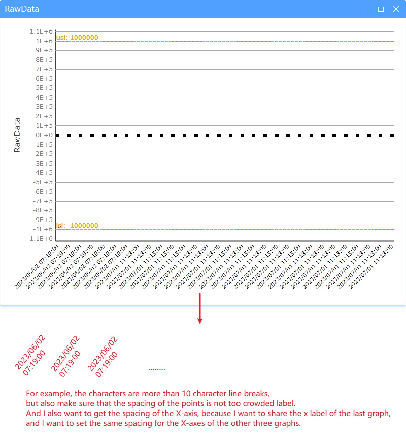

Question2:The X-axis label in the last figure is too long. I hope it can be displayed as a line wrap if it is too long, and the spacing between X-axis points and points can be widened

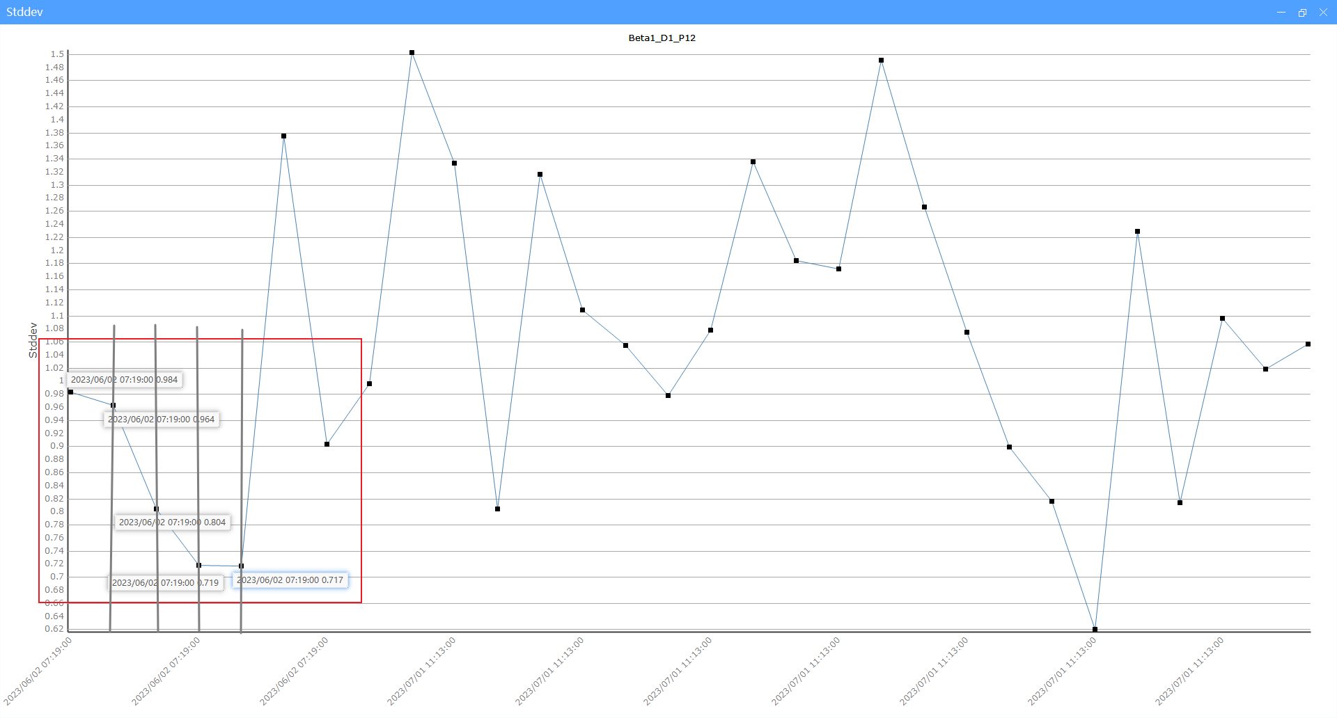

The X-axis names of the first five points in the red box are the same, I hope that each point can correspond to its own X-axis label, and then each point should have vertical lines, such as the gray line I hand-painted in the red box (it should be tchart.Axes.Bottom.Grid), I expect that each point has a corresponding X-axis. And they all have Axes.Bottom.Grid
